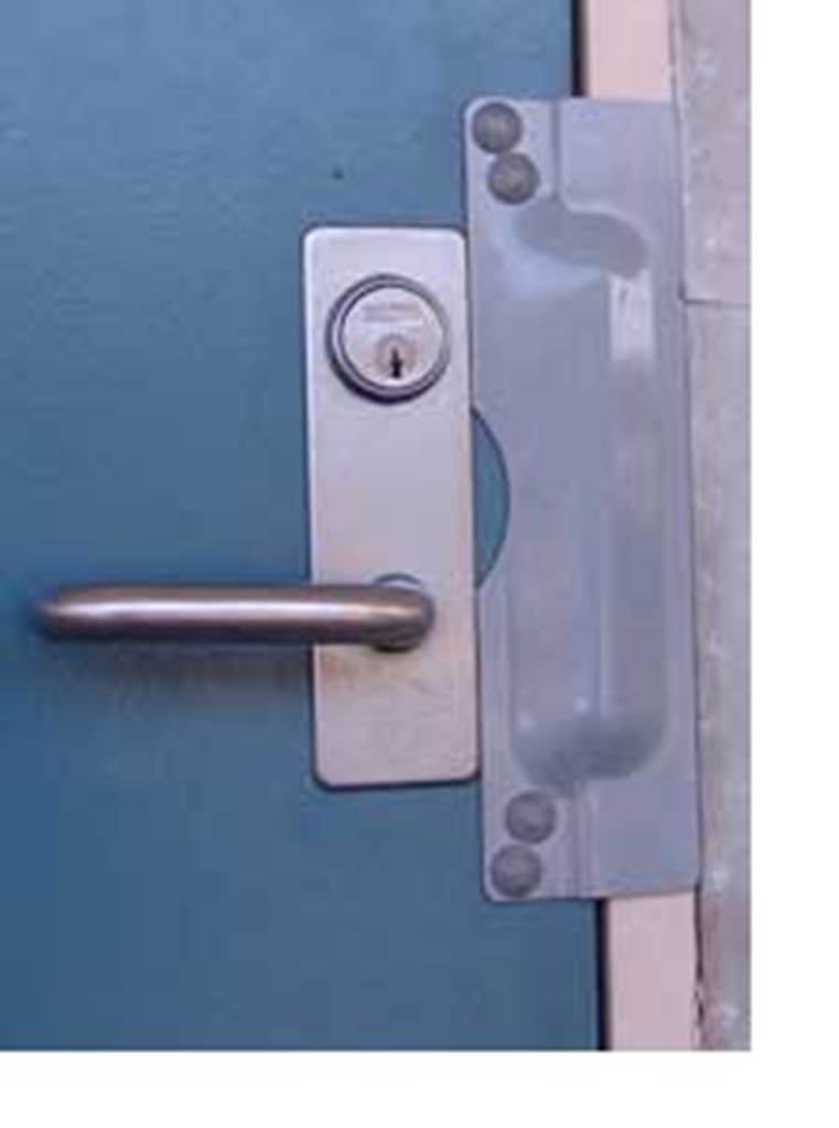

Use exterior metal doors with metal framing, no glass, opens outward, exterior lock bolt guard, with exterior security hinges. Rationale: Classified.

Interior rebar across windows. Reverse exterior door to swing outwards and add exterior lock bolt guard and security hinges.

opens outward
Our doors have to open inward due to the snows and ice, but those are great tips where they can apply.
