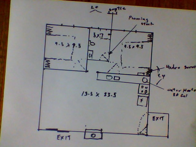

# Posted: 2 Jul 2015 05:21pm
here is a hand drawing of a 24 by 24 cabin we built 15 years ago .it had 30 in. doors throughout .all the inside walls were 2x4 and insulated for sound. May help

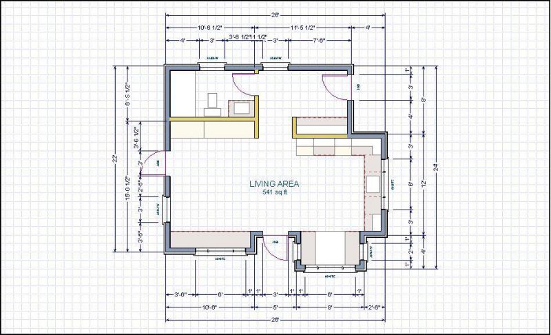

# Posted: 2 Jul 2015 07:23pm
This is a plan I'm working on that seems to be quite similar to what you are doing. I personally don't see the need for a bedroom. By code a bedroom has to have at least 76 square feet of space with a minimum width of 7 feet 1 inch.
The main problem with bedrooms is "what does it do with the space when you aren't sleeping in it"? It's basically 76 square feet of space in a small cabin for a bed, maybe a small closet, and if you like the room really cramped, a dresser.
I prefer a Murphy bed in the main space. Some people say "Oh, no! I need privacy when I go to bed!" Well, the bed is only down when you actually sleep in it, and I'm guessing that other people aren't milling around your cabin when you're going to bed. In the morning put the bed up and you have a useable room. Some Murphy beds even have built-in desks or dining tables so that the bedroom becomes an office or eating area when the bed is up.
Why set aside so much space for a single function (sleep) in a small cabin? It's not like your brain cares if the bed is isolated by four walls while your asleep.
In my plan, the Murphy bed is the long yellow rectangle on the north wall of the livingroom. There is a closet next to it (smaller yellow rectangle).
Layout plan
Layout plan

The Murphy bed is an interesting idea (although my wife's a dedicated napper, so it would get used more often). Beds do take up an enormous amount of space.
