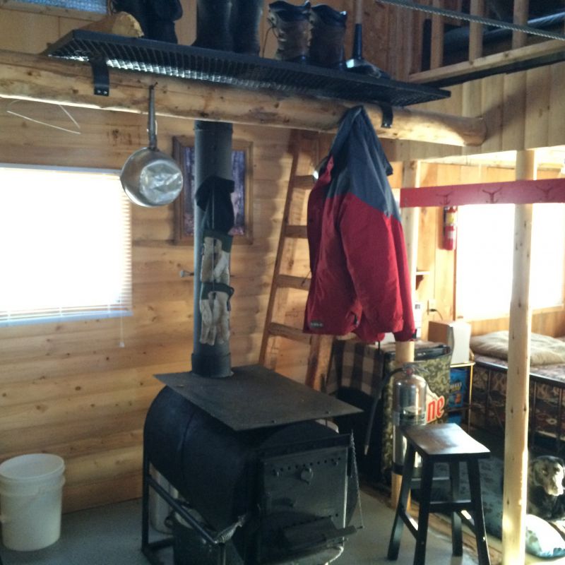

# Posted: 1 Mar 2015 08:42am
Here's the well casing hooked to my stove which was made out of a boiler stack. 1/4 steel with a flattop and a wood furnace door.
# Posted: 1 Mar 2015 09:19am
Looks good! I was looking for a lighter gauge steel pipe to do the same thing. It is not easy to find and in y case the weight was a concern. I got things work for now and will make some adjustments come spring and have things ready for this fall.
