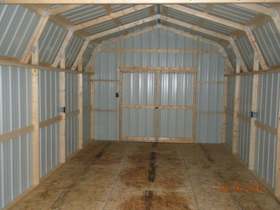

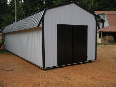

I am looking at putting a prebuilt shed on my property to use for partial storage and weekend cabin use. I have found these shed that are built on 4 x 6 treated skids and framed with 2x4 at 24"O.C. The outside consist of 29g metal siding and roofing and its screwed directly into the 2x4s and purlins. What issues would this cause if I was trying to frame this up a cabin since it is just fastened directly into the studs. Does there need to be plywood in between or do I just worry about doing that for the inside? I want to be able to put a wood stove and a few beds in there for a hunting cabin and this seemed the most cost efficient. Thanks for any help as I am a newb. 6777959_orig.jpg

Better put a vapor barrier under the metal or that thing will drip water or I guess spray foam insulation is the other option.
Code for habitation is going to be different. If its not heated, your insulation is a non issue. Normally, habitation is 16" OC, sheer walls with plywood outside. I suspect the tin is to make it lighter? I suppose you could custom order it, tell them you want 16" OC, you area, to get right insulation, may have to go 2X6, what about roof ventilation, you want some air space above insulation etc.

My guess is someone might stay there 1-2 nights a month max. I do plan to put a stove in there so I guess the spray insulation would spray directly onto the metal then add the plywood walls... correct? We are in Middle Tennessee so the winters and summers aren't too bad except for humidity. As far as roof ventilation would it be possible with this type of a shed?

Why not just go with a pre-fab wood shed and finish that? They make nice cabins. The cost difference might not be that great as opposed to trying to modify the metal aspect.

Yeah I'd look into a portable building. All wood and true walls. Looks like there is hardly any studs or anything. Could be very difficult to do interior. Plus the overall strength and security of good framing will be worth it in long run.

The pre-fab all wood are about a grand or more higher than the metal. The metal have studs 24.OC while the all wood ones around here are 16. OC. Might just have to look at the wooden sheds or try and find a used one that we can possibly add on to at a later date.

I would stay away from the metal shed if at all possible. With the metal walls you will be forced to insulate with closed cell spray foam insulation. Spray foam is the only insulation that will create a perfect vapor barrier and prevent moisture from condensing on the metal walls.
The other issue is that the spray foam will literally glue the metal panels to the studs. If you ever have to replace a metal panel due to damage, the level of effort would be enormous.

Another vote for staying away from the metal version.
If you've ever seen a metal pole building going up, if it is going to be conditioned on the inside, they use large batts of fiberglass insulation wrapped in plastic that is applied to the exterior of the perlins before the metal is installed. This is a continuous, unbroken vapor barrier & thermal break.

Well we found a shed to purchase that is all wood with shingles instead of the metal siding. They seem much nicer so I guess you get what you pay for. Unfortunately I decided to contact the county to see if there were any restrictions here in Middle TN and I am unable to put a shed on the property that I OWN unless there is a primary residence there. Seems kind of ridiculous so I am going to have to start looking at other options since I don't live on the property. I guess they could consider it a residence but then they'll want septic and a whole other load of mess to get that set up. Anyone else ran into these problems or have any suggestions.
