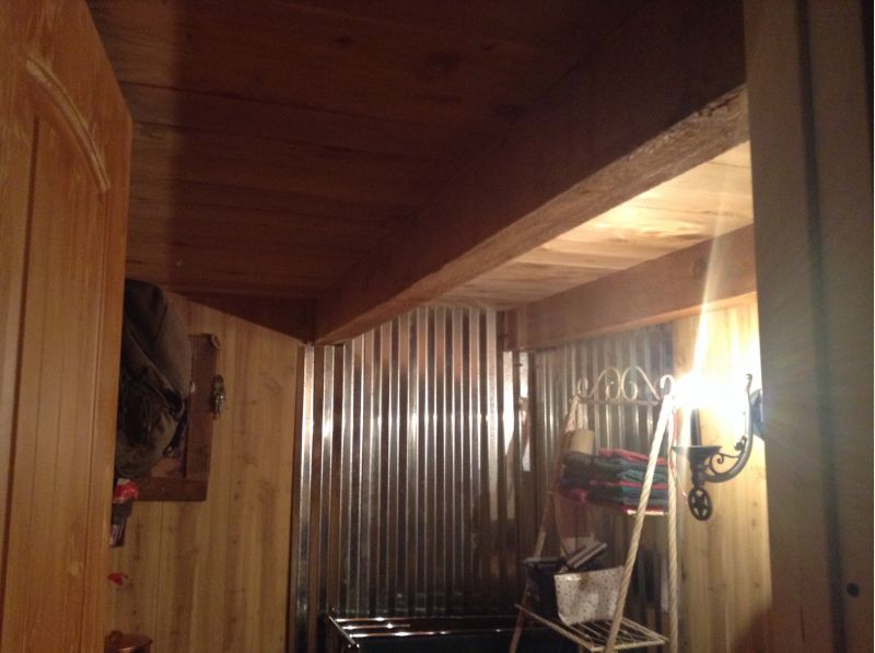

This is a picture of the shower ceiling, which the loft is right above. This is the back right corner of cabin. Will we need to put something over the wood and if so what. We really wanted the cedar to be seen.

Just wanting to shoot this topic back up. I am preparing to install my shower and I am trying to decide how to handle the moisture
hueyjazz
# Posted: 28 Oct 2014 11:58am
Bathroom fan with light and a heater is a god send in my book.
Controls moisture and take the nip out of the air when wood stove hasn't kicked all the way in during the winter.
