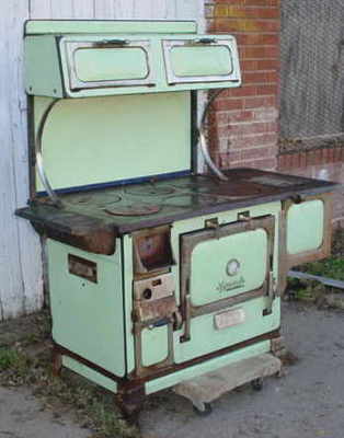

3. I want to put in a wood stove like the one in the picture below but I have no idea how much clearance is needed also will it heat the entire cabin?
This info should help: Wood Stove Clearances.
