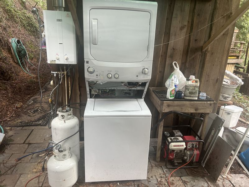

Did a load of laundry yesterday using my old Honda generator (battery bank was low). Bought it from a friend for 100 when he switched to a new larger HF Predator. Only 1400w I think. Ran the washer fine but wouldn’t spin the dryer. I think I changed the oil when I got it. Valves, ignition.. forget it. Probably outlast me.

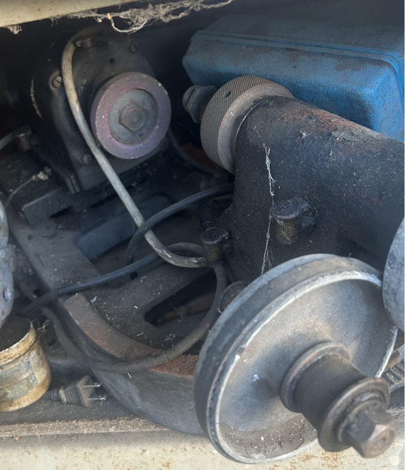

Came across my old valve and seat grinder trying to clean up my life at the house last weekend. Did a lot of work with it, especially in the old days of cast iron heads/seats, particularly when unleaded gas became the norm.
Never had much of a problem with Hondas, aluminum heads with hardened seats and good valves. They were mostly just dirt bikes though, not the kind of hours mentioned here.
