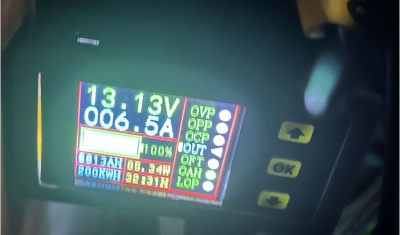

A test problem yesterday I haven’t figured out. First, I fired up my big Onan two cylinder lp generator I haven’t been using. Plugged in the two 40 amp Meanwell chargers, 80 amps into the four Valence LFPs as usual. Lately I’ve been using the old gas generator I built the cabin with, will only put in 60 amps. I have a voltage/amp gauge, the negative battery cable from the bank passes through a ring sensor (I forget what you call those) that gives the amp gauge its reading. All the above is working as normal.
Then I thought why not jumper and plug in the one spare Meanwell, in theory it should give me 120 amps into the bank. No such luck, still 80 amps. I recabled, switched them around, tested each one individually..
Thinking maybe the generator was maxed out, I fired up both generators and plugged one charger into it. No help, still only 80. Hmm. Maybe the bank will only take in 80? Looked it up, they should take more easily. Cables? I’m using car battery cables, thick. Gauge? It has at least two digits, should go up to 99 at least. Terminals? Nothing got hot..
I don’t need the 3 chargers hooked up, probably better having the one spare. Just confused why it didn’t work, the faster charging would be nice.
Pic of the gauge with no charging going on the 6 amps is going out powering cabin stuff.
# Posted: 9 Nov 2024 03:28pm
Only thing I can think of is the Battery Resistance. As they charge the resistance increases & amps taken drops. Just my guess, anyways.
# Posted: 9 Nov 2024 03:55pm
Good guess Steve. I have noticed that normally, as the bank charges the amps do drop from 80 to 70ish as the voltage goes up slowly. Maybe above 80 it’s more pronounced. Going back to the grid today, the spare charger is still out so when I get back will give it another try.
