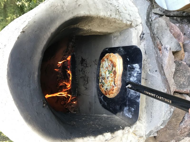

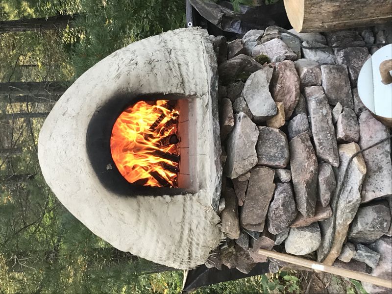

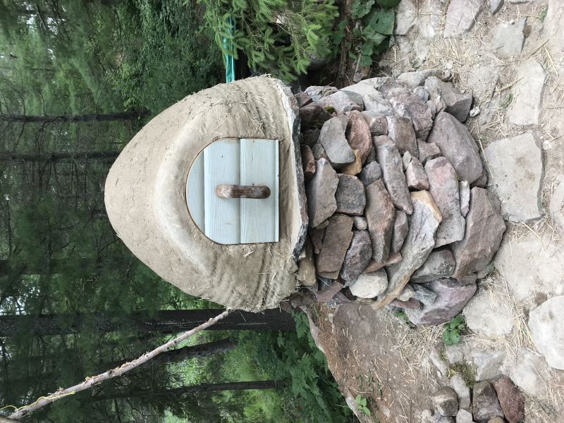

We have had this on our list for years, but this summer Mrs Fishie and I build a wood fired pizza oven at the cottage. Other than the straw for the cob external layer, all items were dug on site. It was a lot more work than I planned, especially after my ATV died, and I had to wheelbarrow 3/4 of the material to the build site. Not sure I'll ever eat enough pizza to gain back the calories I burned building this, but I'm going to give it a try.

# Posted: 9 Sep 2021 09:25am
i did a door as well. We have slow cooked a couple things overnight in it

Quoting: jhp Assuming there's a chimney in the back with a damper we can't see...as long as it drafts you could smoke in it.
No chimney for us. It is a specific calculation to get the door height correct so it will vent while burning and not smother itself with smoke.
Chimney isn't necessary, if you do the math, and it lets so much heat out that we decided not to go that way so we could do long slow cooking in it.
