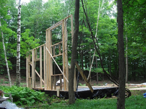

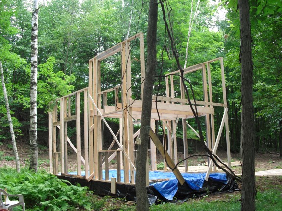

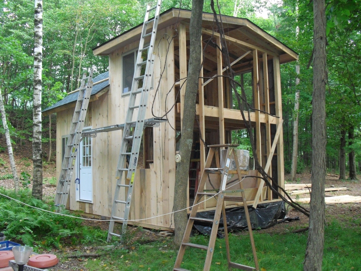

Here are a few early construction photos. The deck is laid on 6 x 6 skids, 2 x 10s, insulated, with sheet metal on the bottom to keep the critters out. It took about three weeks from first to last, with my builder working between 20 and 30 hours a week.![1__8_AM_July_20.jpg 1__8_AM_July_20.jpg](https://www.small-cabin.com/forum/shared_files/uploaded/612/4703_1.jpg) 1__8_AM_July_20.jpg
| ![2__11_AM_July_20.jp.jpg 2__11_AM_July_20.jp.jpg](https://www.small-cabin.com/forum/shared_files/uploaded/612/4703_2.jpg) 2__11_AM_July_20.jp.jpg
| ![3__3_PM_July_20.jpg 3__3_PM_July_20.jpg](https://www.small-cabin.com/forum/shared_files/uploaded/612/4703_3.jpg) 3__3_PM_July_20.jpg

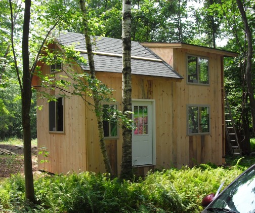

The flared roof over the loft was the last change to the plan--made the day I ordered the windows. A suggestion of my builder's. Originally, I thought I wanted a dormer on one side. In the end, the cabin is a foot higher than I wanted (just trying to keep a low profile to be as unobtrusive as possible), but it is nice to be able anywhere to stand up in the loft. Working with my builder (a real craftsman) was terrific, btw. Height ended up at 16'.![CIMG0120.JPG CIMG0120.JPG](https://www.small-cabin.com/forum/shared_files/uploaded/612/4704_1.jpg) CIMG0120.JPG
| ![CIMG0121.JPG CIMG0121.JPG](https://www.small-cabin.com/forum/shared_files/uploaded/612/4704_2.jpg) CIMG0121.JPG
| ![CIMG0123.JPG CIMG0123.JPG](https://www.small-cabin.com/forum/shared_files/uploaded/612/4704_3.jpg) CIMG0123.JPG

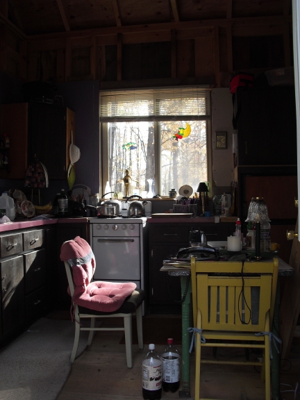

I'd been collecting furnishings at various thrift stores and yard sales for the past year.). The big prize was the kitchen cabinets. The propane fridge lived in a screen house for two months while I waited for cabin construction to start. Got a wonderful camp-sized propane stove (forty bucks--even the pilot lights work) at a local place a lot like Habitat for Humanity.![CIMG0158.JPG CIMG0158.JPG](https://www.small-cabin.com/forum/shared_files/uploaded/612/4706_1.jpg) CIMG0158.JPG
| ![CIMG0136.JPG CIMG0136.JPG](https://www.small-cabin.com/forum/shared_files/uploaded/612/4706_2.jpg) CIMG0136.JPG
| ![Ellens_Place.jpg Ellens_Place.jpg](https://www.small-cabin.com/forum/shared_files/uploaded/612/4706_3.jpg) Ellens_Place.jpg

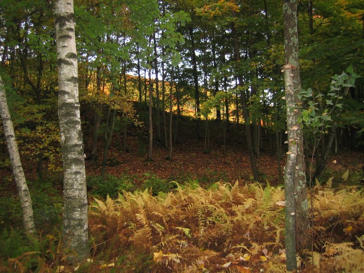

It never ends. The wood for the deck will be delivered Friday. Just a simple 6 x 16 job, resting on the abundant local rocks. Half a day's work, even for me. LOL Then I may do some more insulating. The cold weather inspires me. Planning on ship lap pine with some cedar for all the walls that aren't kitchen. Should keep me busy for a few years. Then there's the ram pump and the dream of running (or at least creeping) water. Next year...next year.![sept_cabin.jpg sept_cabin.jpg](https://www.small-cabin.com/forum/shared_files/uploaded/612/4709_1.jpg) sept_cabin.jpg
| ![CIMG0153.JPG CIMG0153.JPG](https://www.small-cabin.com/forum/shared_files/uploaded/612/4709_2.jpg) CIMG0153.JPG
| ![autumn.jpg autumn.jpg](https://www.small-cabin.com/forum/shared_files/uploaded/612/4709_3.jpg) autumn.jpg

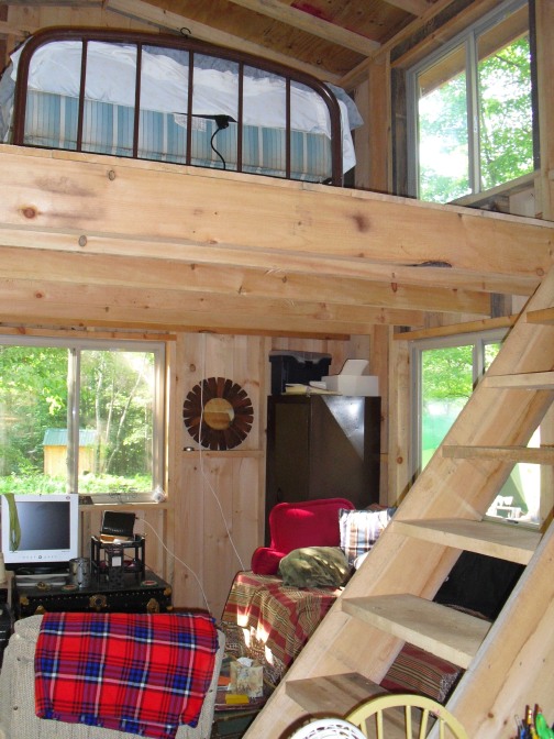

Fantastic cabin, love your architectural design. It's wonderfully satisfying, isn't it, to make a place that's truly and uniquely your own. Far better than "pretty good, I think, for a single lady in her late fifties."
Quick question about the treads on your loft ladder: How are they supported? I didn't see any cleating in the photos. Dadoed?

Sorry to be a busybody, but for safety's sake, I hope you will glue and screw some sort of cleating under those treads. 1x2' furring strips would do the trick easily and economically.

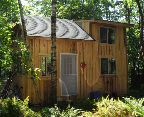

Btw, is that one of those "instant" screen doors (that attach with velcro tabs) at your entry? If so, are you happy with it? It looks quite nice in the Ellens_Place pic.

Thanks, KC and Gary O. The cleats idea sounds much simpler and quicker than the more drastic measures I had been considering. And something I can do myself, which is always the deciding factor! I will add the cleats ASAP.
As for the screen door--good eyes! Yes, it is a foldable, velcro attachable screen door. It's great for a temporary fix (which is what it is), but when I get back in the spring I'll be adding a real door. Curiously, it's one of the many gifts I received while scouring the county for used furnishings. I was at a yard sale at a lovely cabin in the woods, and got to talking with the owners. The woman eventually gave me a bunch of stuff for free, including the screen door, saying "you'll need this." Boy was she right! There is a bond between those of us who build houses in the woods.

I concure w/ KC. The steps must have better support. Since they are not Dado'd, Solid Risers would help a lot if sandwiched between each step. (But you loose the openess of the ladder.) Cleats at the very least. As they are now, one day a stair tread "will" split & the injury will likely be painful.
Quoting: KC cabin Sorry to be a busybody, but for safety's sake, I hope you will glue and screw some sort of cleating under those treads.

Hope this helps, p0rtia. Your cleats would look something like this:

Wow, thanks for the illustration, KC. I will do it first thing in the spring when I return. Much appreciated. I've been absent from the boards for a bit, as a windy spell inspired me to do some insulatings (!). I am now cozy and warm, and the wind may blow to its heart's content. I also constructed a small (6 x 16 deck--can you call it a deck when it's only three inches above the ground!?). Anyway, it's a wonderful addition, and I already have my eye on roofing it over and screening it in. Ah, the plans go on forever, but honestly, I got much more accomplished this year than I thought I would--and I think I've got it organized to have my builder slap up the interior walls while I'm gone this winter. I'm enjoying my last few weeks here at the cabin. Off to family for Thanksgiving, then back up here till it gets too cold (even with insulation!)--sometime in early December, I imagine. Thanks again, all.
