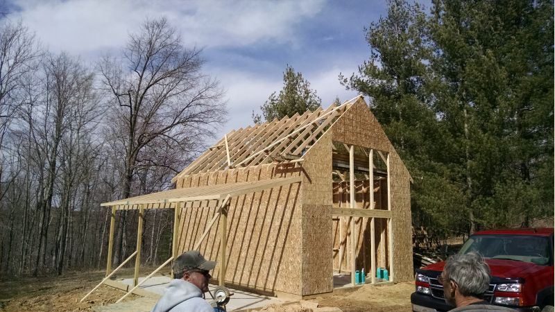

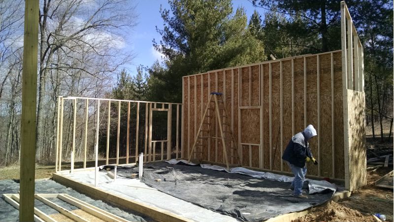

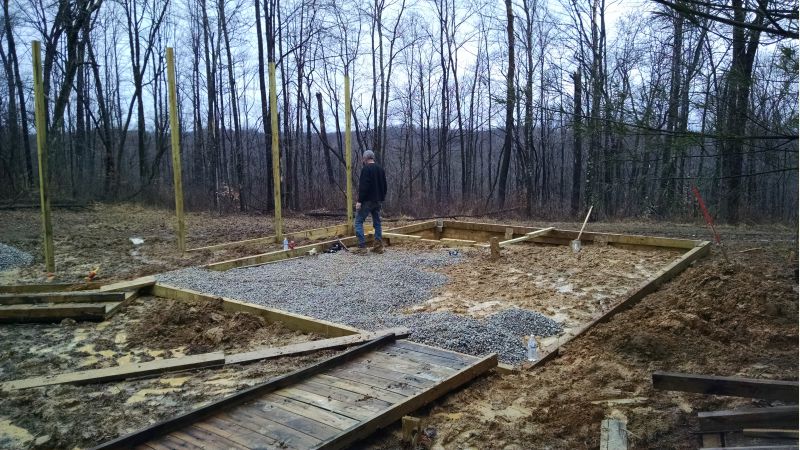

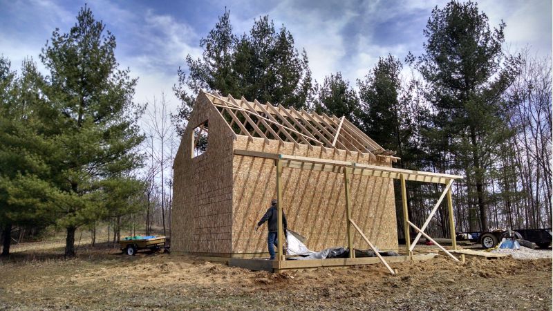

Finally getting around to posting some pics of the cabin build. We made some headway this past weekend but will be taking Easter weekend off. Hopefully the following weekend the metal siding will start going on.

Cool! Welcome to the neighborhood. Ours is 16x20 in the northern part of VC - it looks like yours is close to that. Congratulations on having the good sense to build on relatively flat ground; ours is about 10' off the ground on the porch side. Good luck to the build and keep us posted.
Smawgunner
# Posted: 31 Mar 2015 17:43
Whoa! That's coming along quick! Looks outstanding.

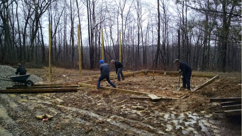

# Posted: 1 Apr 2015 09:14

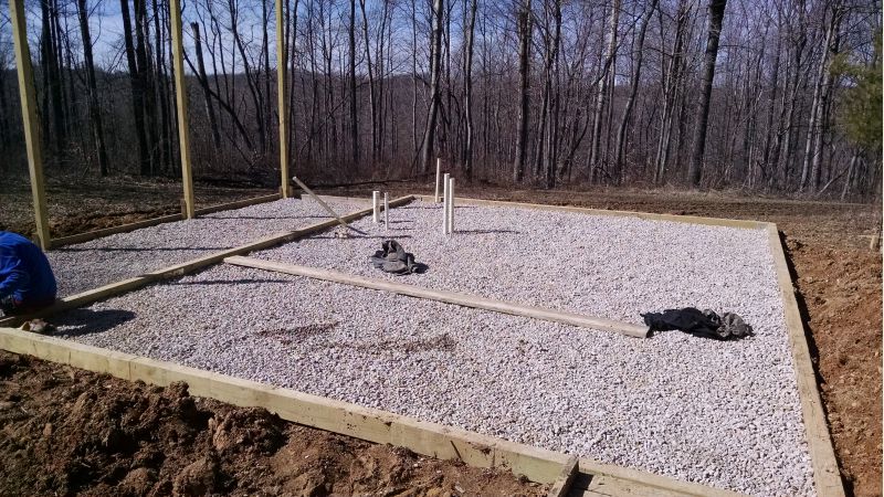

That's looking really good, off to a darn good start I'd say. Looks like a really nice spot you picked there to build on. I am curious however, what did you do on top of the gravel ?

Steve_S - Concrete is going on top of the gravel and we were supposed to do that last weekend but it was to wet to get a concrete truck up there. Might have to wait until after the April showers.
# Posted: 1 Apr 2015 19:03
So the concrete will sit inside the 6x6's that you built the walls on ?

Yeah the concrete will go up to the top of the 4x6's. Basically my foundation is 4x6 posts in the ground every 6 feet and then they are cut at grade level and then a 4x6 is laying across all of those.
The cabin will be 18x24 with a 18x12 loft. There is also a 24x9 covered patio on the one side. The exterior will be metal siding and the interior will be tongue and groove 1x6 pine. There will be a bathroom and the rest will be an open floor plan with a small kitchen. It will be completely off the grid. I will have a wood burner and most likely a direct vent propane heater. I also plan on having a propane hot water heater, propane oven/stove, and some propane lighting.
There will be a solar set up of some kind and for water I will have a cistern in the ground which will catch the water off the roof. Water will be pumped out of the cistern with a 12 volt pump. I believe I have been talked into a small pressure tank as well to help with the water pressure.

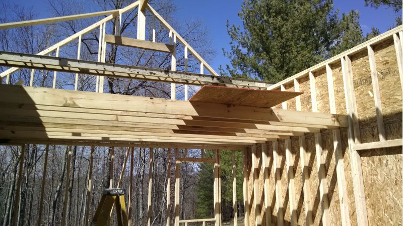

Are your walls 12' 2x4's?
Where did you attach your loft joists? 4' below the top of the wall?

GreatOutdoors - Yes the walls are 12". I will have to double check when I am down there next weekend, but I believe there is 3'6" between the finished floor of the loft and the top of the wall. We do have a 10/12 pitch so the head room is close to 6' not to far from the wall. We debated this for at least 30 minutes before we installed the floor joists. We didn't want the floor joists to low in fear of making the first floor feel like a dungeon.

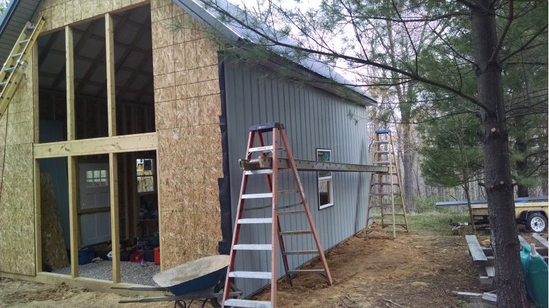

VC_YamahaRider
# Posted: 14 Apr 2015 08:56

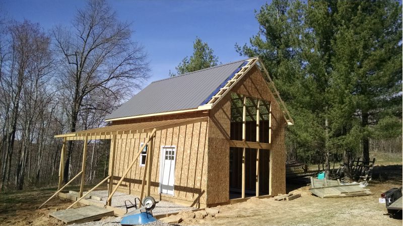

Updated photo. We got all the windows and door installed, purlins on the roof, fascia on, and got all but one sheet of metal on one side of the roof this past weekend.

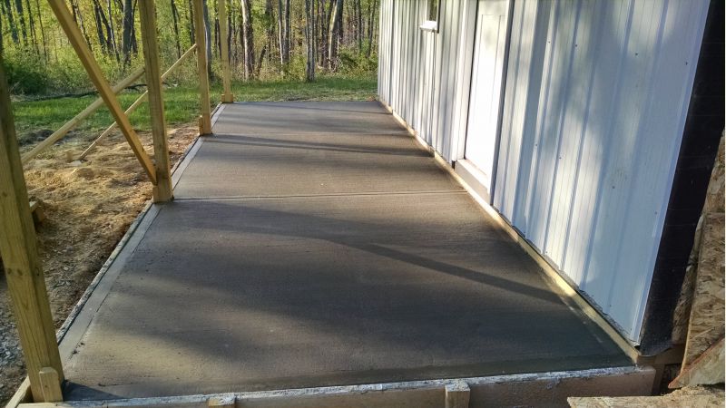

# Posted: 5 May 2015 10:05

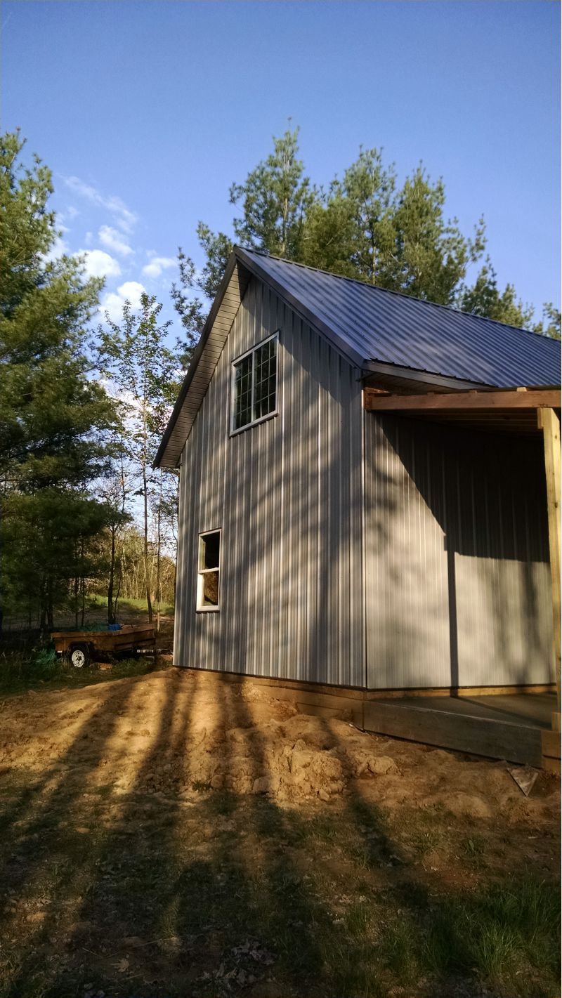

Updated Pictures. Concrete is poured and another wall of metal up. Plan to finish the exterior this up coming weekend and put the wall of windows in on the South side wall.

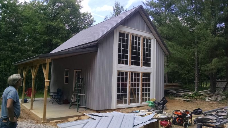

VC_YamahaRider
# Posted: 8 Jun 2015 14:47

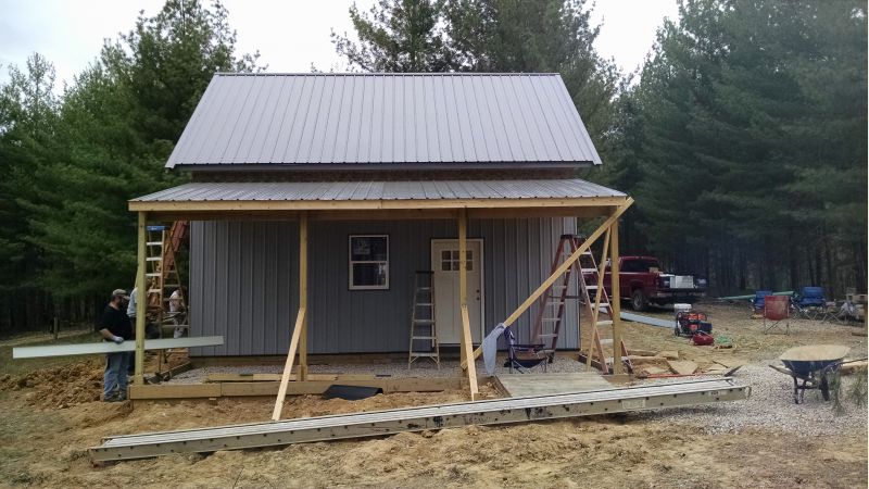

Updated Pic. We are pretty much done with exterior. We will now move to the interior but probably not until late summer.

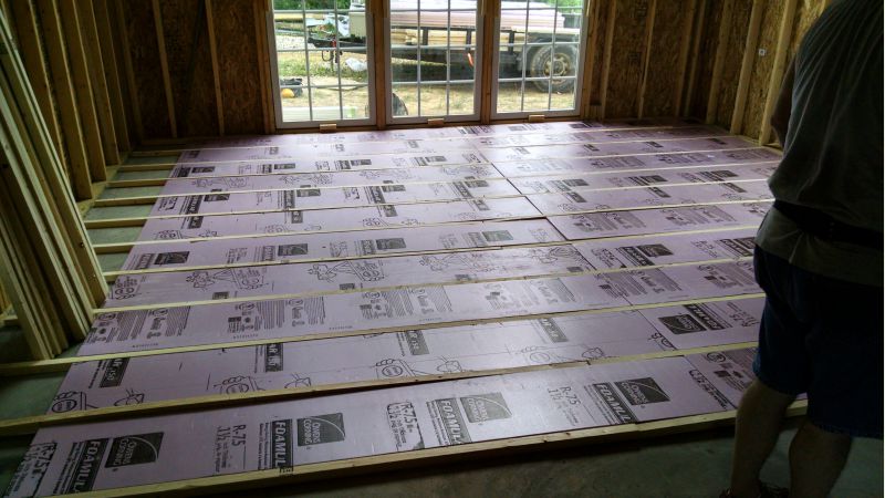

My biggest dilemma now is how exactly I will be doing the floor inside. Right now it is a concrete slab. My thinking was to put 2x2's down 16" OC and then 1 1/2 in. foam insulation between them and then 3/4 in. pine veneer plywood on top. We would finish off the plywood with some type of polyurethane.
VC_fan
# Posted: 8 Jun 2015 18:40
Too cool. But I think you need a few more windows.

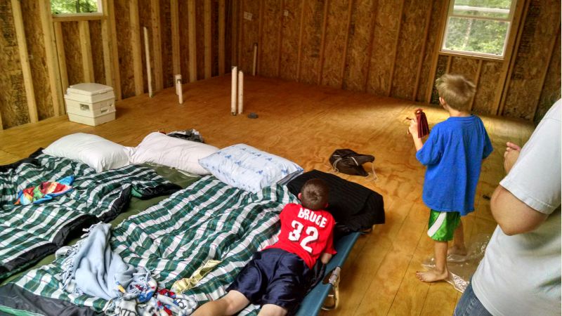

# Posted: 21 Oct 2015 21:11
Well it has been a while since I posted and updated you guys on my actual cabin build. It has been a busy summer and we have got a lot of stuff done but it has been slow. Both of my boys play sports all year round so any weekend they didn't have games we were working on the cabin.
Flooring insulation
Flooring insulation
Finished floor
Finished floor
