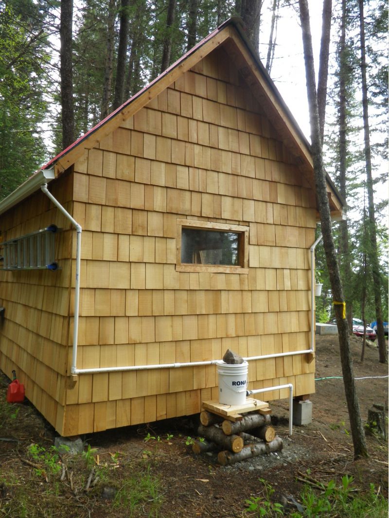

Hey All
I just posted a new video about our new cabin rainwater harvesting system, heater and pump.
Have a look
https://www.youtube.com/watch?v=funUNu9zVLQ

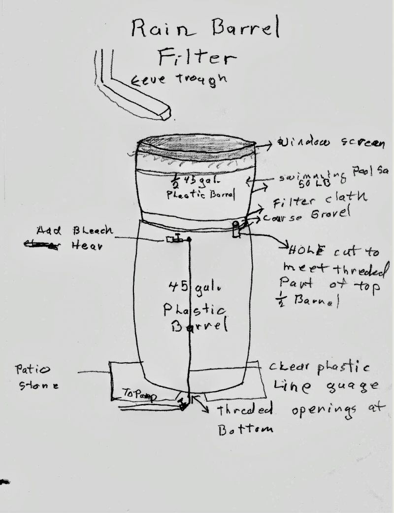

Looks good. We collect rainwater into a 1500 gal underground tank. I built a filter for the rainwater using a new 5 gal bucket, rocks, pantyhose filter and no-see-um mesh filter.
Dekagoldwingers
# Posted: 11 Jun 2014 10:16am
Here is the filter.
Ontario lakeside
# Posted: 11 Jun 2014 01:34pm
Hey Dekagoldwingers
I may decide to build a filter and a first flush diverter. But Im hoping that I wont need them. Our roof is steel and we have no overhanging trees, so the contamination is minimal. Do you drink from your system?

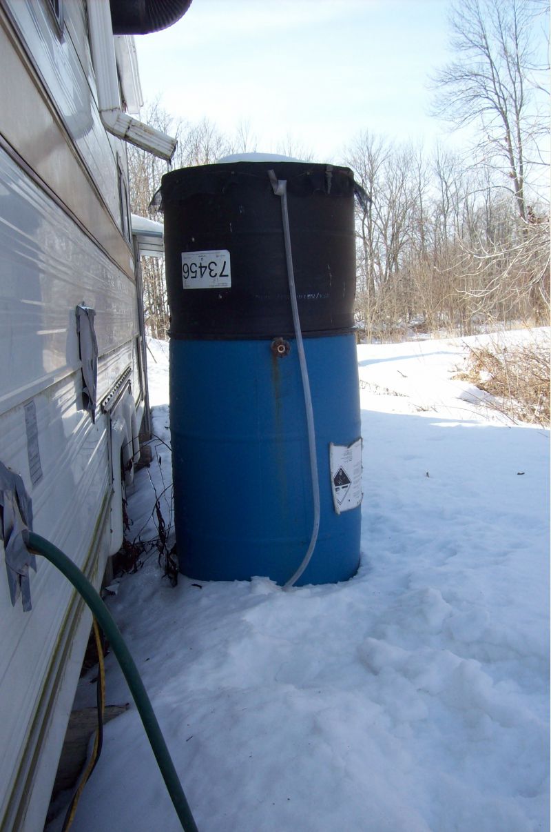

# Posted: 11 Jun 2014 03:00pm
I think you will want a filter of some kind !Birds do fly!!! here is mine for what its worth.. we boil it to drink just clorox once a week for every thing eles..
