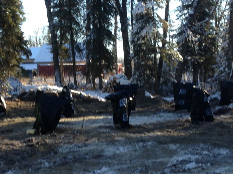

We have about 12 acres, on road, and a few neighbors, but for the most part you wouldn't know it. Our trees are old, anc cutting them to make room (and safety) for the cabin just killed us. One was 81 feet tall, and a real beauty.
We have a lot of spruce beetle kill, so cutting a healthy tree hurts. one of our frequent visitors

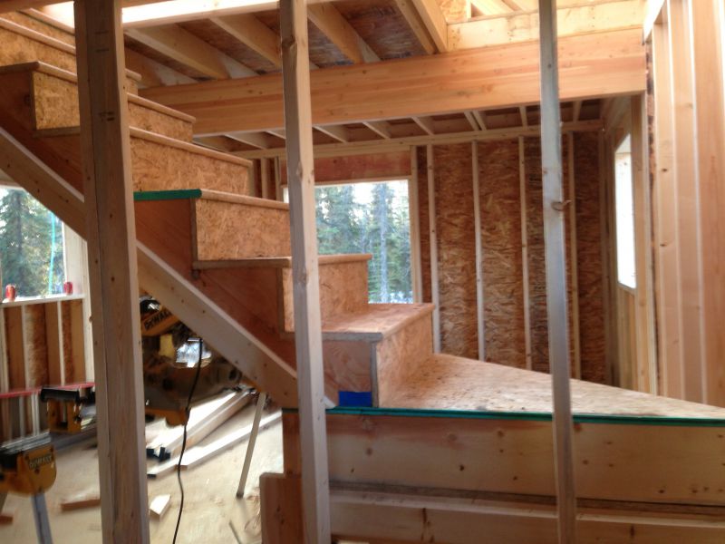

Just off the top of my head I see that your stairs take up a lot of space and I believe that the top step is in the center of the loft correct? I see how your stairs could be changed to make a little larger kitchen with room for upper cabinets. Are those steps going to be built very soon? If you could delay them it would be good. How important is it for the stairs to be open? Or are you okay with "walling" them in?

The stairs were there before I could correct them
I am okay with walling them in, however my husband is afraid it will be difficult to get things up to the loft if we do.
This is frustrating, because I had planned on ships ladder width stairs, but got regular 36" width stairs. And now, tearing them out would involve huge structural changes to the loft decking.
Any help you can give, whenever, is appreciated. As I said, the stairs are there, now we have to live around them. It can be done. I just need to visualize it.

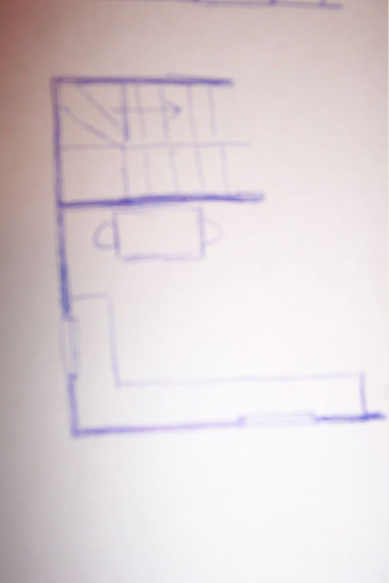

Got 3 VERY crudely drawn up (embarrassingly drawn) but gottta go trick or treat now...I'll post them later!

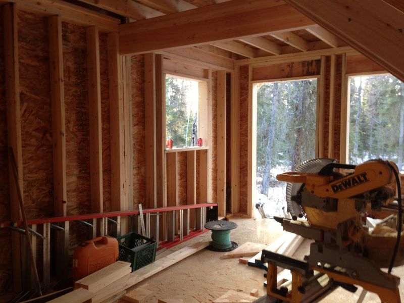

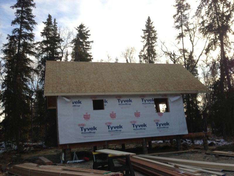

No building today, my guys wanted to take their kiddos trick or treating (and since they travel a LOT, I thought that was a fabulous idea--babies aren't babies for long).

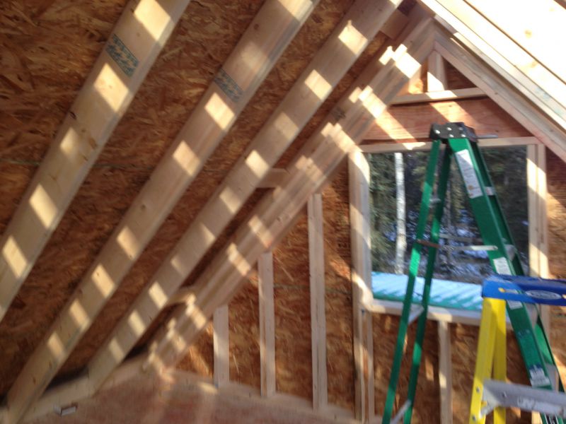

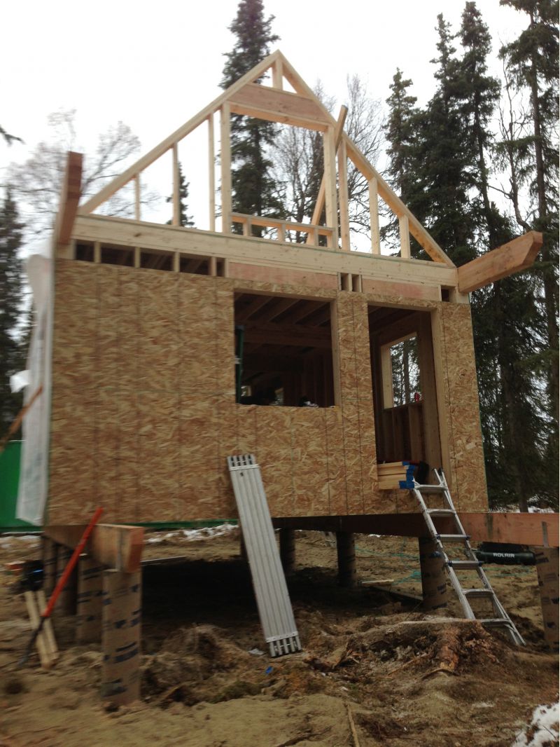

But, I am going to post more pics. Can't resist.  One side of roof sheeted
|  doorway
|  My big upstairs window
|  the infamous stairwell

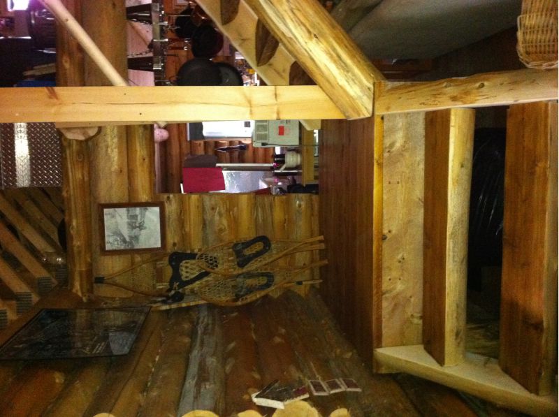

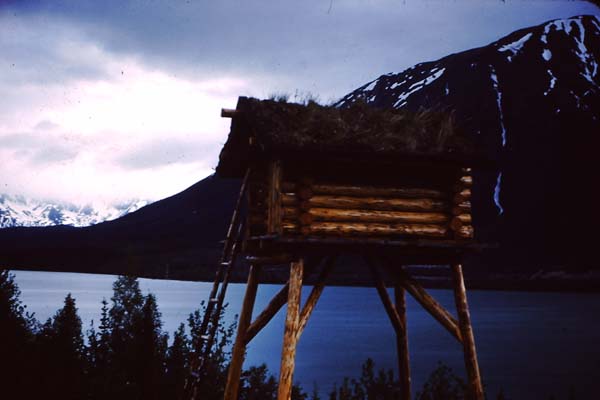

Welcome! It is looking really nice. I liked reading your posts so far and we had issues with our stair size and placement as well. They ended up interfering with our front door and we had to replace our front door with one that swings to the other side. Now every time you walk in to front door you have to swing the door completely open to get by the stairs. Not happy with that at all!!
Anyway, my grandparents were missionaries in Alaska (my mom was born there before it was a state). I am putting up a couple pics of some structures they built. Food storage

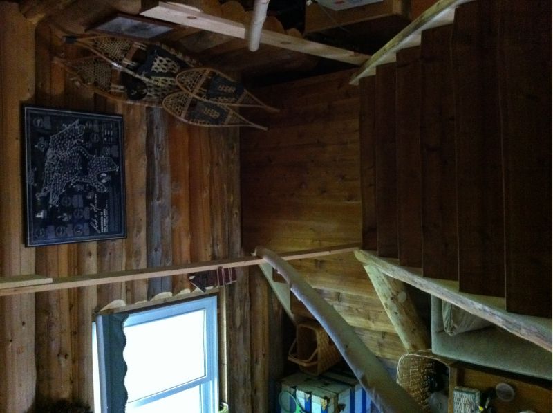

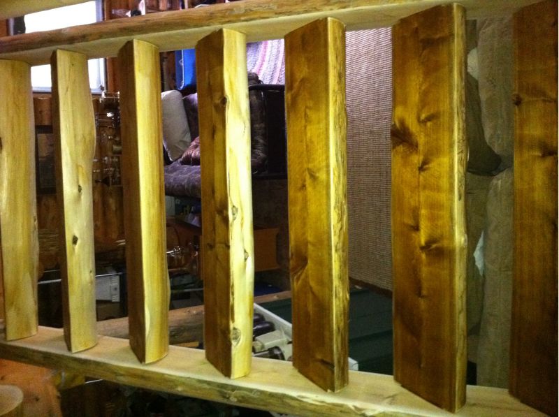

Welcome to the forum. I can relate to the space issue on the steps. I wanted a log spiral staircase in my cabin but because of the amount of space it would take we went with regular log steps. Got most of the wood from our property, white cedar. Sorry the photos posted like this on my phone they were correct. image.jpg

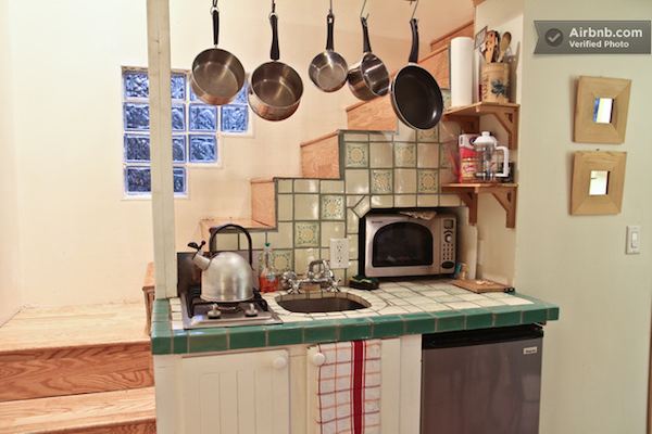

pulled this from a tiny house website. . . obviously doesn't address your cabinets or counter space, but thought it was kinda neat use of space with an L shaped stair. smallcabinwithups.jpg

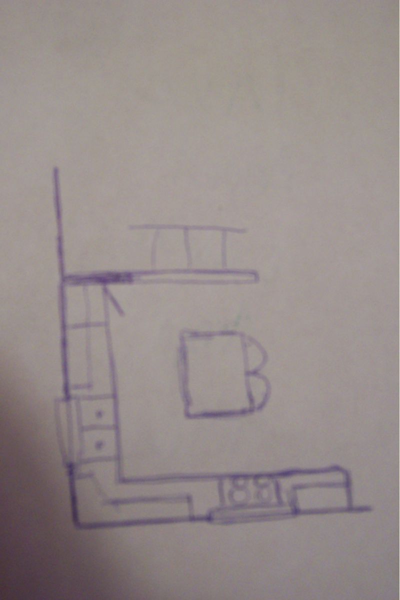

Okay...this is just not my day apparently cause nothing seems to want to work for me- phooey!
The layouts I drew up very quickly yesterday are very sketchy and not in scale and the 3rd one I don't know why I can't find it now on my computer but after my camera charges-it is dead from last night-I can take another pic. So bare with me...these kind of little struggles make me nuts!
I was thinking about your stairs being already done and how you said it would be difficult to mess with the loft floor and I agree. What if you were able to just change the lower portion of steps? If you made a landing and had the stairs come down off of that running parallel to the upper steps. Instead of L shaped they would become U shaped. This takes the bottom landing space that is dead space out of the kitchen and puts it in an area that is already free space. Then depending on what you decide to do for kitchen layout you could either wall in the stairs or leave them open.
Here are a couple of the things you could do: In the second layout I realized there would not be adequate room for the island the way it sits, but it could be moved over. I also wasn't sure if you had a table and chairs that you for sure want to use instead.
The layout I can't find on my computer right now was like the first. It created an L shaped run of cabinets only instead of the front wall they ran down the sink wall and formed the L on the stairs wall. The table stayed where you currently have it.
If you decide to leave the steps the way they are you would probably be best to L shape along the front wall and "float" your table in the space that is left (in the cubby area where your steps come down). Does that make any sense?
The area under your steps should be utilized...it is very valuable and would make an excellent closet or pantry-you could even get some storage from the area on the bathroom side down low.
Being in Alaska and wearing heavy coats and snow boots, have you thought of where that stuff will be stored? You could put hooks on the wall where the door swings but there isn't much space. Perhaps a short wall on the other side of the door would benefit you as well-more hook space for hanging and a place to keep boots/hats/gloves...all that stuff-you could put it in a closet under the stairs but if it has a door on it your items will not dry out as quickly and you will be traipsing snow threw your cabin to get to it.
Just some of my thoughts...don't mean to create anymore dilemmas Since you will be living there full time for a while until your bigger home is built I figure it may as well function the best it can! and these are just suggestions...please don't feel pressured...you know best how you will use your space   Oct._2021_2012up_.jpg
# Posted: 1 Nov 2012 01:53pm
Wow...those are really "sad" drawings! Don't laugh

Cabin calls: Sure am glad we have the chainsaw!! That cache view is gorgeous (whereabouts?). We are on the Kenai.
SilverwaterLady: Your stairs turned out beautifully. I hope you love them. The layout is the exact same as ours.

MontanaGirl: I originally was going for something very like that. Funny! I have that pic on my pinterest page for the cabin.

Last night my son, the carpenter (commercial) came over to look at my dilemma. He agreed changing the stairs would be a no go. He gave some ideas for tread depths and such, but we agreed they just weren't practical. Bless his heart!!
Then last night in the wee hours (hmm, wonder if it was Trollbridges churning thoughts that got mine going) I came up with an obvious solution.
I went back to placement of the wood stove where we originally had it. I liked it there better anyway. Next, I thought outside the box. The kitchen, I thought to my sleepy self, doesn't have to be there.
This is what I designed: http://urbanbarn.icovia.com/icovia.aspx?projGuid=85D3797B-FD5D-483C-AA47-680D73D980B6
Again, just hit launch.
What a relief!!
I rather like this layout. Love it when "mistakes" work out better than the original.
