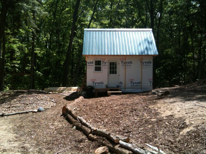

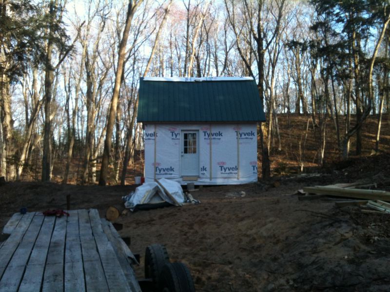

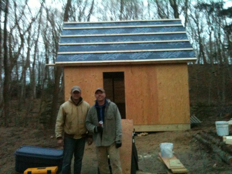

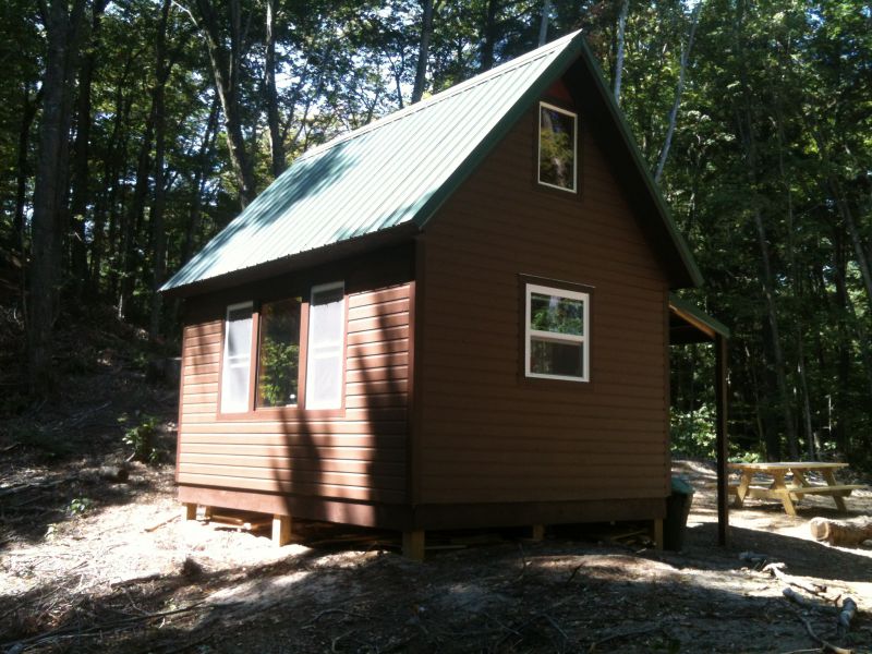

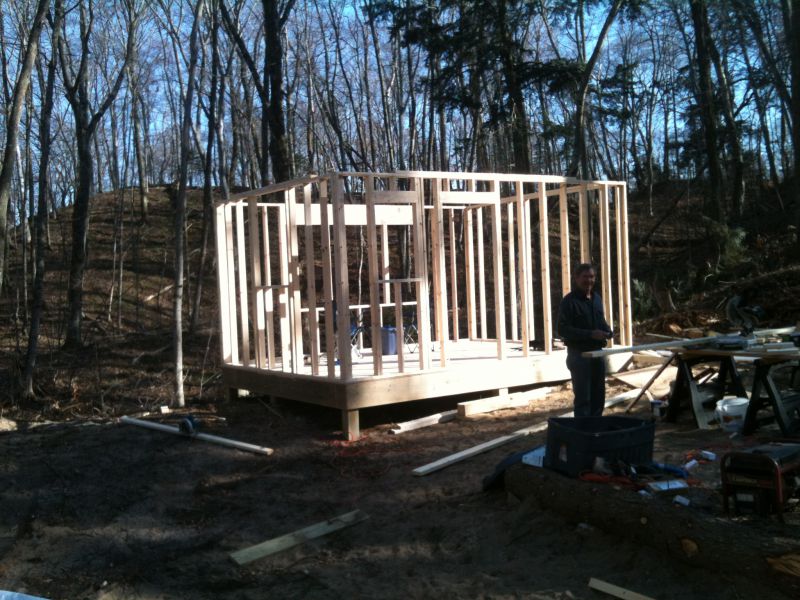

just built this in about 5 months - started mid April. Got it framed and roofed in 5 days with 2 buddies. just finished staining it last week. here's the first few pics. will post more once I know it works.
let me know what you think.
site
site
taking shape
taking shape
going up
going up
weatherproof
weatherproof

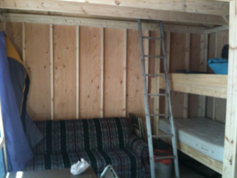

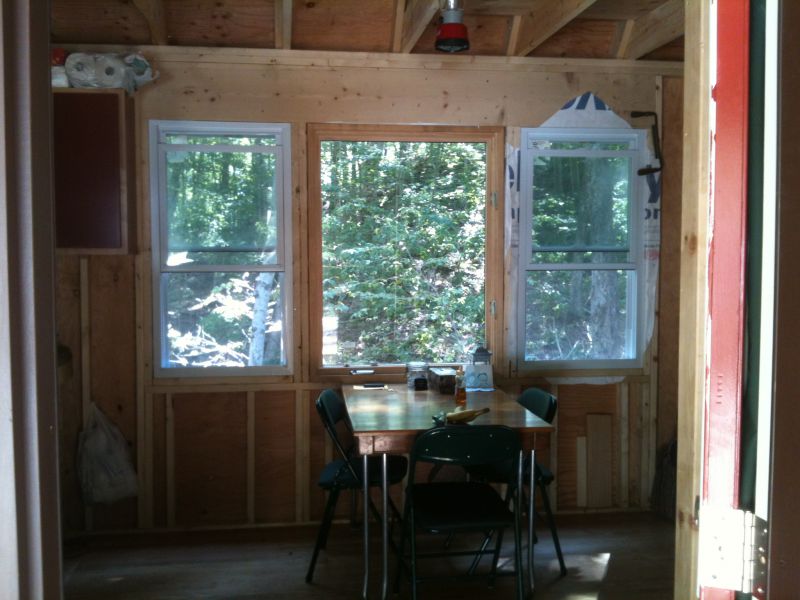

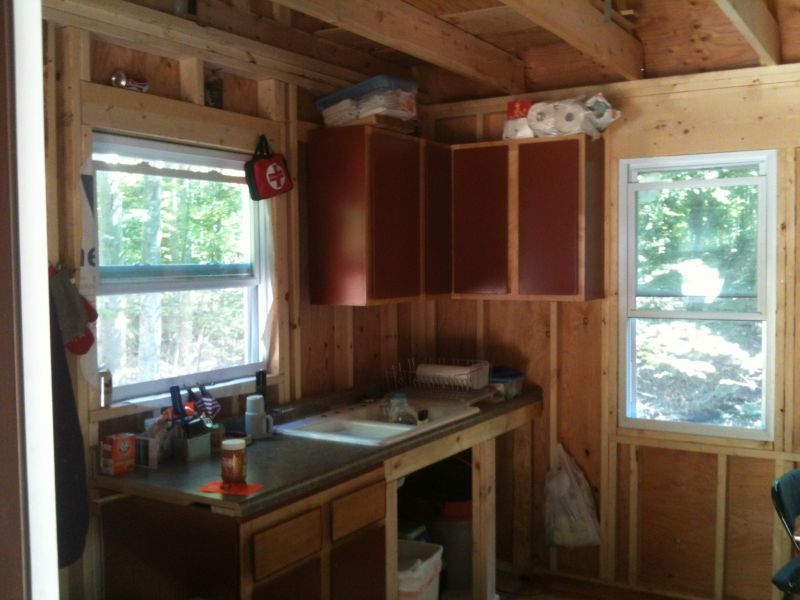

more pics
summer
summer

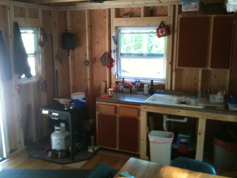

counter
counter
picture window
picture window

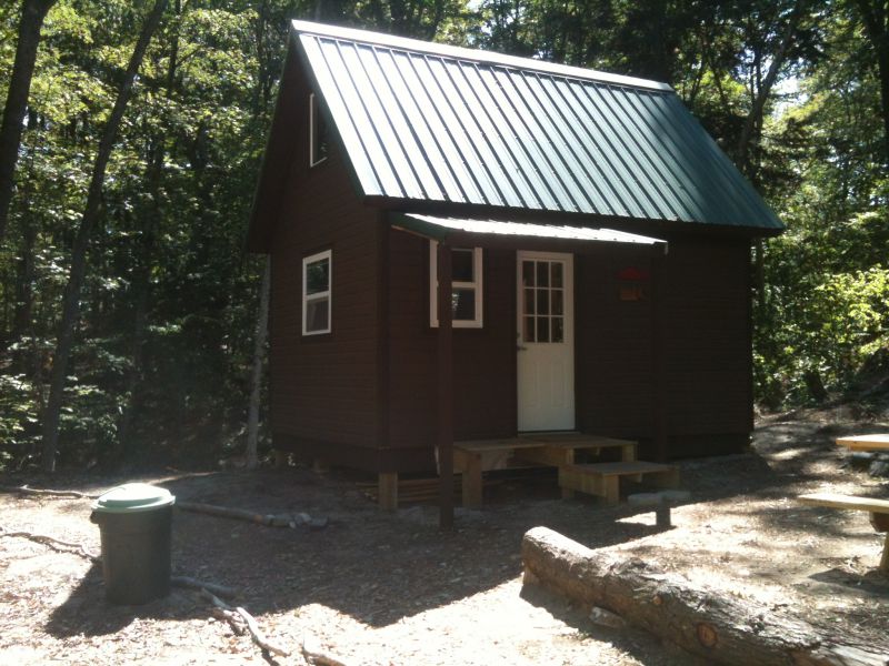

finished up.
finished
finished
front
front
hanging out room
hanging out room

me and one of my friends

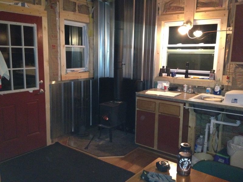

next fall I'll insulate and panel the walls with pine t&g. after looking at some of the posts I may consider a propane wall heater. Any suggestions on brands and models?
"stove" and hearth for wood stove in the future

I really like your cabin. Probably because it reminds me of ours so much. It's the same dimensions but I know your roof is a higher than our because our pitch is 12:12 but somehow, your's looks steeper. Our walls are shorter than yours which may change the appearance of the roof pitch. Your inside photo of your kitchen is almost exactly like ours!
Your windows are larger which I wish we would have done in the first place because we have added another one last week on a long wall because there is so much canopy shade that the cabin is still dark in the daylight., We also installed a loft window last week (which we had framed over a year ago) but finally got around to installing it.

The roof if slightly steeper than 12:12. But I don't know exactly by how much. We had cut the first two rafters at 45 degrees, then realized that we weren't going to match up with where we had set the ridge beam, so we recut a bit off the bottom ends of the rafters to steepen the angle and match the beam. The loft floor is 2x8, I'm 5'9" and can comfortably stand up at the peak. (with work boots on).

What kind of stove do you have? I bought a little Vogelzang 26. The little one with two "burners" on top. I think it will be enough.
I didn't insulate the floor and thought I'd see how it goes. I work in my uninsulated garage at home with a pair of wool socks and crocs (as slippers) and my feet never get cold. I figured I'd use that strategy for as long as I could.

We have a "Logwood" stove about 27" longX 16" wide and about 24" tall. These are all approximate dimentions...I just can't remember.
We try to keep the logs to a length of about 20." It does a fabulous job. When we go to the cabin and it's cold (20-30 degrees) once we start a fire, it's around 65-68 degrees within 20-25 minutes. It will maintain that temp for a few hours with just 1-2 small logs (3-4" in diameter).
I hope you do alright with no insulation in the floor. I have a good friend with a 24X36 cabin in West Virginia where I've stayed a few times and his floor is uninsulated. He says that in the cold winter (deer season) his gas furnace never quits running because of the heat loss coming up through the floor. Our cabin is about 30" off the ground so I figured I better insulate. After we insulated we put 30# felt paper under the 3/4" plywood floor (on top of the insulation. No problems! I wouldn't waste money putting 6" in the ceiling. We have 3 and 1/2" and it does fine. I'm sure it gets a lot colder in your neck of the woods.

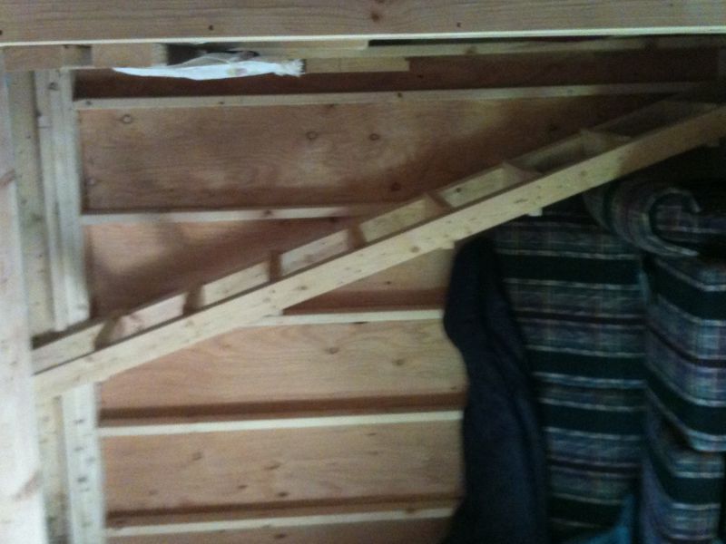

Wall height is 8'. It is a 12x16. The roof pitch is 13/12. The foundation is made up of 9 6x6 pressure treated posts set in concrete. My site is very, very sandy.
I wouldn't have done anything different. I have half a loft in mine and there is room up there for two twin mattresses on the floor. Great for my two kids. I'm 5'9" and can stand up at the peak.

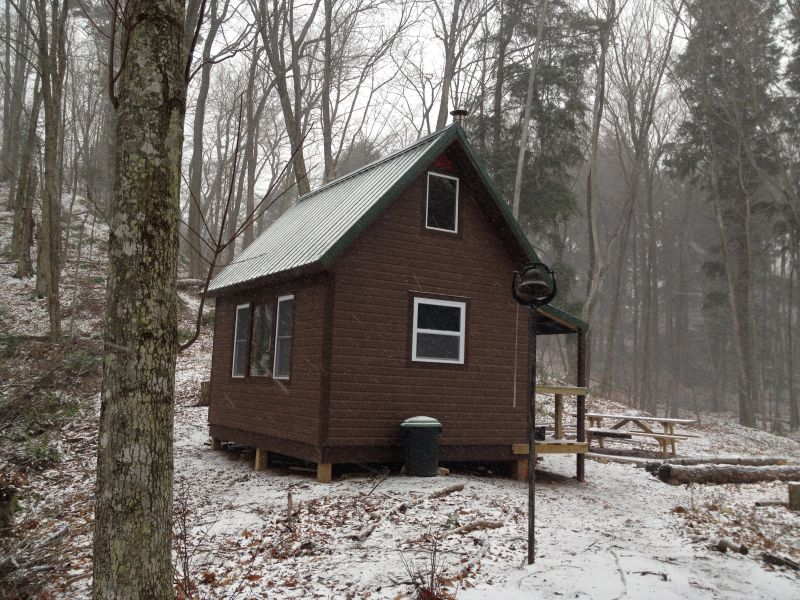

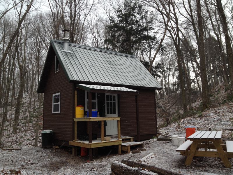

I just noticed that the pics above are pretty old from when I first built. here are a few more updated...

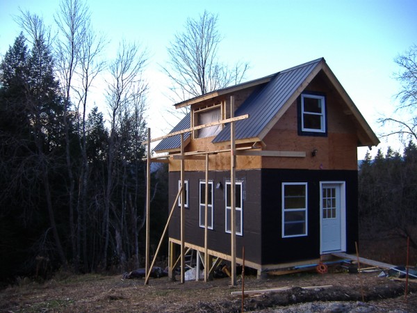

Here's what I want to build in the spring. This is a Peter King small house and probably not 12x16 maybe 10x16 with 10' walls but mine will be 12x16.
tcmatt
# Posted: 26 Nov 2013 02:15pm
That looks super cool. I'd guess that its 10x20.
