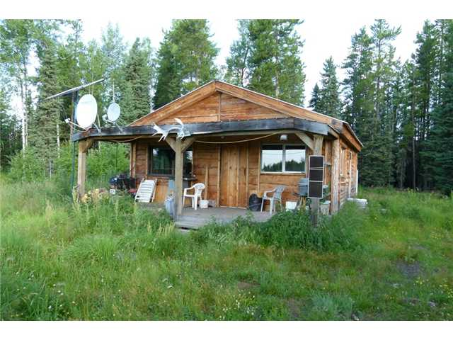

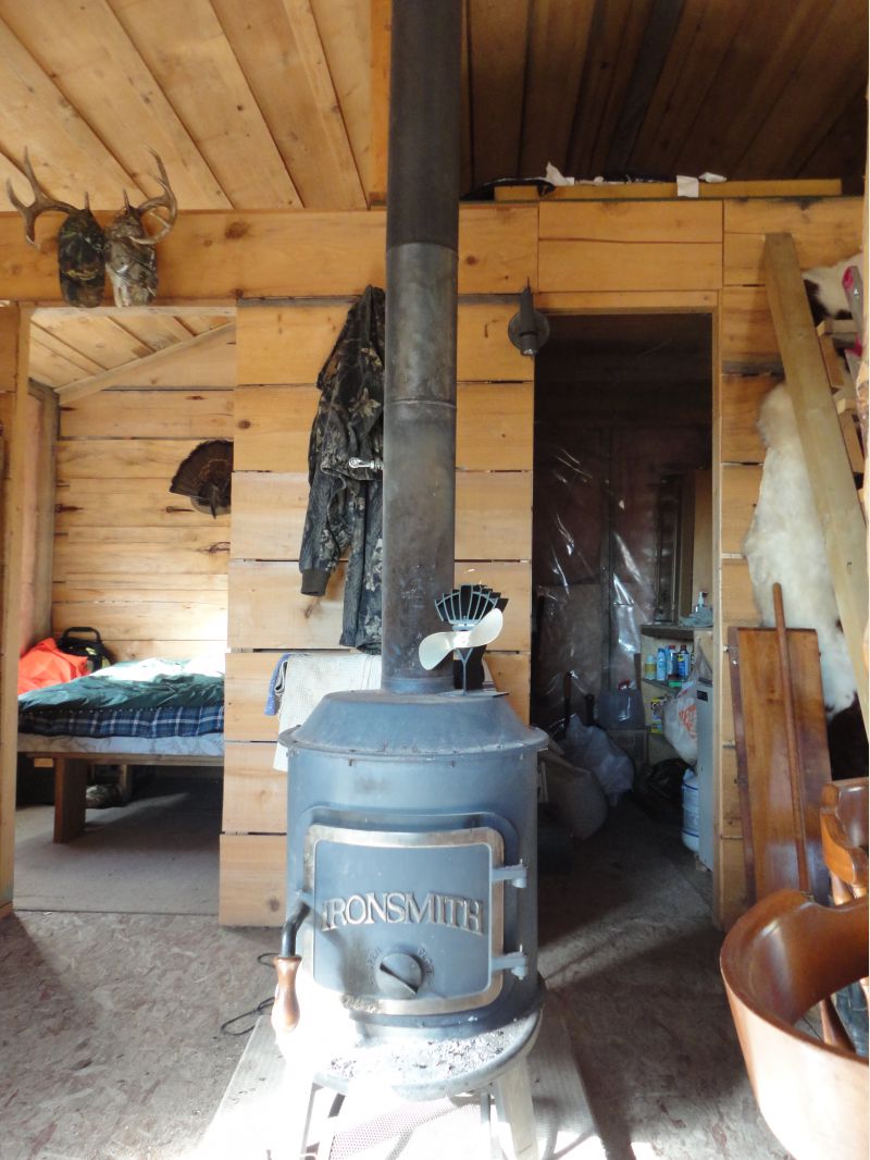

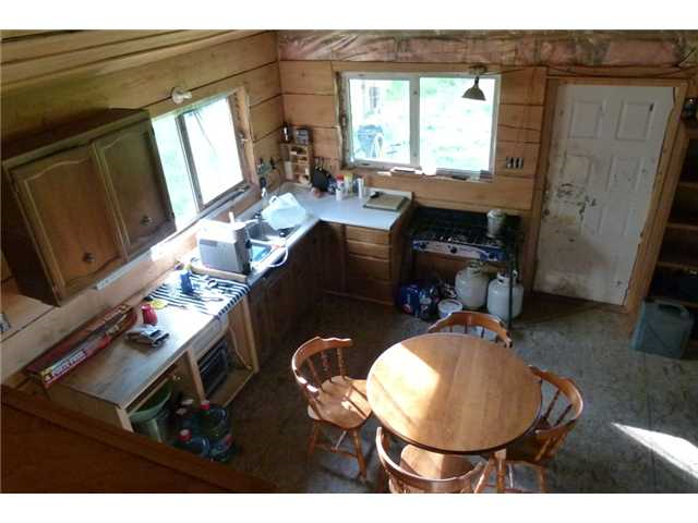

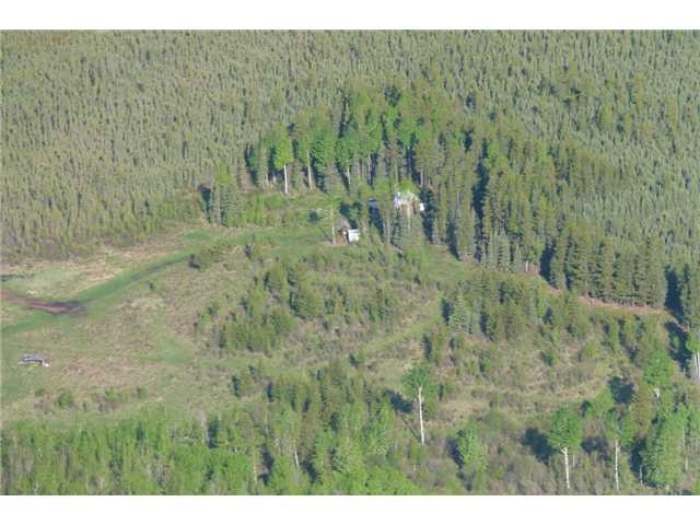

As requested, here are a few pics, just to give a general idea.
exterior
exterior
inside from loft
inside from loft
centre of cabin / stove
aerial shot
aerial shot

From the picture from the loft I see what looks like a Coleman on demand hot water heater. On the kitchen counter.Those come with a shower attachment. You can place the pump end in any water reservoir and the water heats up easily and quickly and you can shower with that.

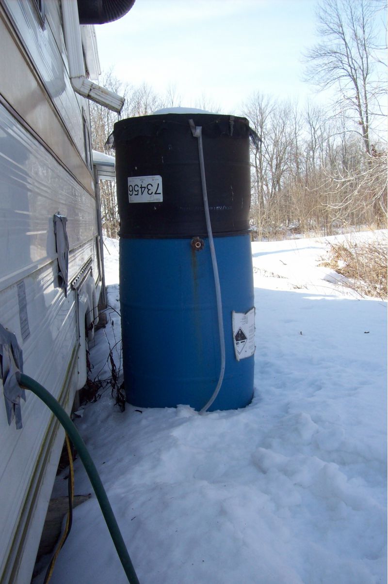

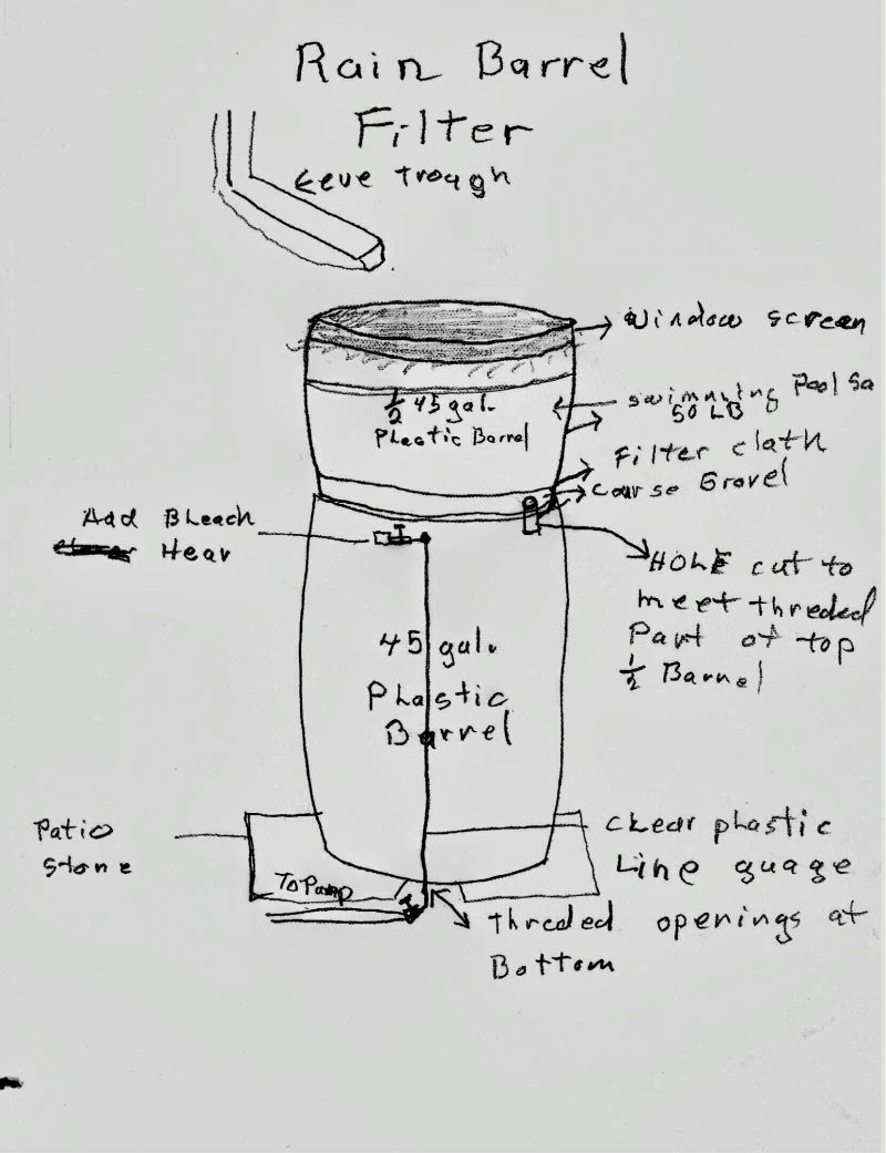

# Posted: 30 Jun 2015 09:34am
sending along pic of my rain water collection system' we also use a solar powered 12 volt Surflow pump to to get the water inside .. for hot water we heat the water on the stove, i think it is unpractical to heat water with solar power .

Well Well...haven't been here in a long time and it looks like they now just let anybody join..
Ill give you my experience with hot water, easy way, and then a little more complicated. first I was (not by choice) away from home for a month or so during dec..-30 temps, no one home to keep the wood stove going so my pipes burst (just one) Long story but I could not effect a repair for a few months so when I returned home I had to improvise ...I had two of those old galvanized plant watering jugs, with the big loop handles. I think they held 1.5 or 2 gallons, I would fill one and set it on the wood stove to warm up (could use a gas stove burner) when it was the temp I wanted I lifted it up and put a bungy cord through the handle. I had screwed a hook into the shower ceiling and both ends of this bungy cord hooked on to this screw.
I would have to reach up a couple times and slide the handle on the bungy cord to keep the water flowing out the head. This worked great...supper simple and I used stunningly little water for showering.
Now I don't know how skilled you are, or what you are willing to try... I will just tell you what works for me ( and others) and you can run with it or not....... First tanks for storing water...hit the ufa or Pevey mart, they often have the 1250 gallon tanks on sale for 650.00- 700 dollars ( don't pay regular price) You want two of these. Now get a plastic 45 gallon barrel.
cut from the top roughly 45 degrees, stretch window sheer cloth over this slanted top, tape or glue in place, route your eaves to empty above this 45 gallon barrel, the water falls though the shear cloth, and debry slides off to the ground. You will want to have this barrel on a stand. Now take a hot pin and poke small holes (6 to 12) in the bottom of this barrel, that's so the barrel cant hold water between rain storms and breed bad things sitting in the sun..call this your pre filter. Now run a line, I suggest 2 inch abs (for your roof size) to the first tank from the barrel, roughly 2-3 feet from the bottom. This first tank is your settleing tank basically. Run another line from this first tank through a 5 micron filter (homedespot) to the 2nd 1250 gallon tank. These tanks are 8 feet in diameter each. You will want to build a 18x10 foot building R20 for these tanks, with r20 walls (shed roof), the tanks on the ground, maybe sitting on foam board, but not necessary, and around the exterior perimeter set square hay bails.. ....the tanks will not freeze this way even through a Albertain winter, you may get frozen water floating on the top during a long -30C cold spell but they wont freeze...trust me on this.You want at least this much storage (more is better, 3 is perfect) as you have 5 people and with your roof size, and as I know the rain fall for your area you just will not have enough collection area, so during the winter you will have to call in a water truck. The trucks hold 3000 gallons so you will be able to take most of their capacity ( 180 dollars for my area) ( most cost effective). I know your thinking costs and how much this will all add up to but trust me it is cheaper than having a well drilled or a divorce, and you risk the second without enough water keep your stored water dark and I even suggest keeping bubble wrap floating on top so there is less contact with the air.
Now I never found the gravity fed systems practical.........just me, mabey others have...I suggest a pump and motor combo that I and my niebours now use...I can get you more info if you are interested but it is the pump and motor from a Bernard tig torch cooling systems..also used in miller coolmate 2 systems if I remember right. The pumps are rebuildable and a company does them in Edmonton.
I am running 10 years trouble free on this set up. pressure is adjustable, though max gallons perminute is something like 1.5 gallons...not a problem for me.

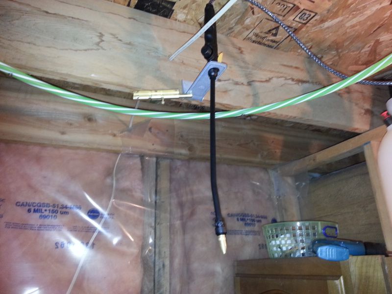

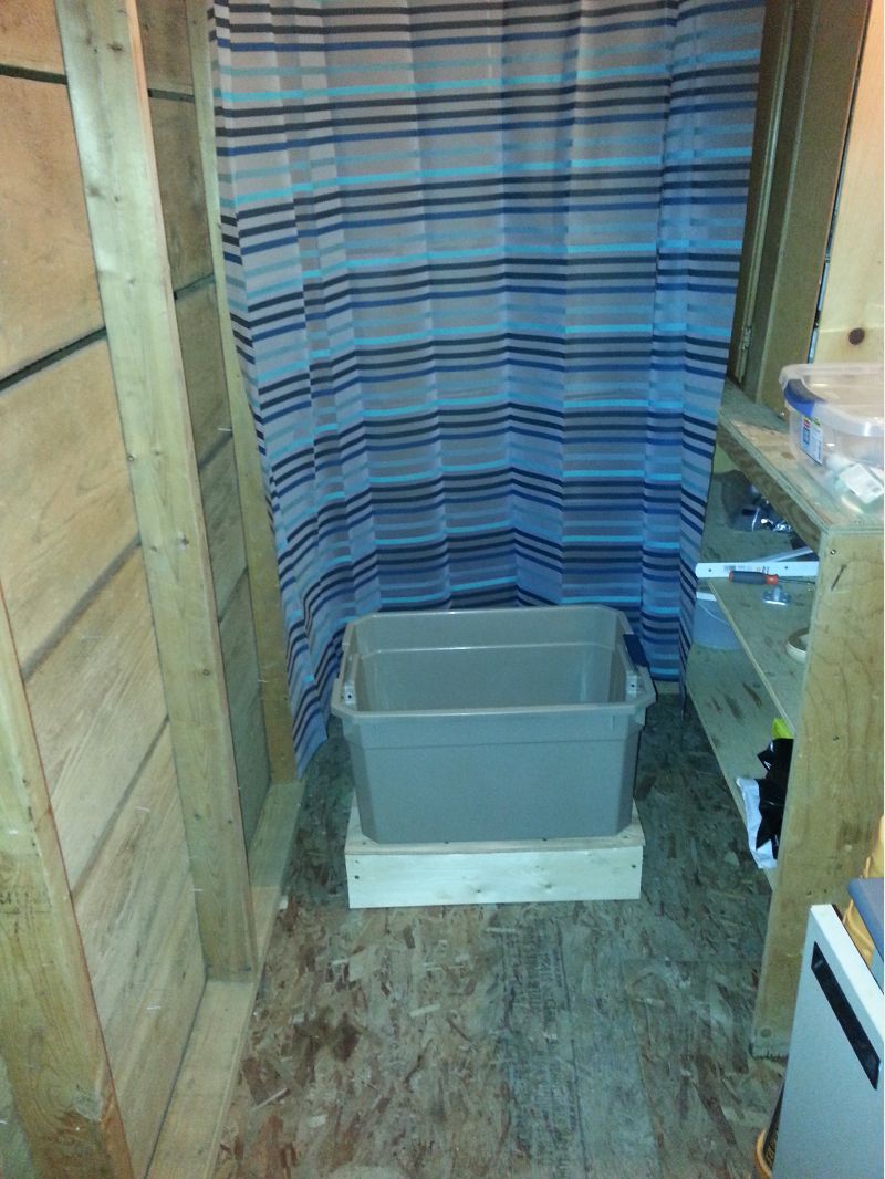

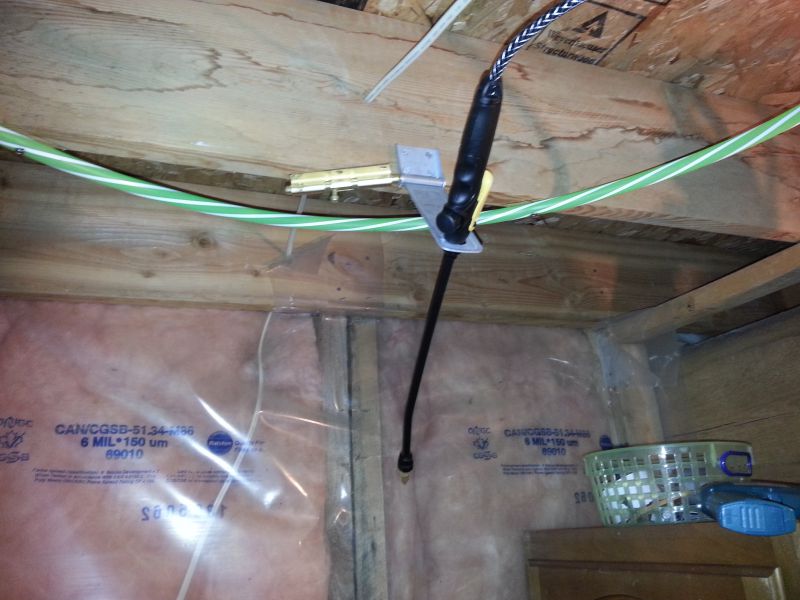

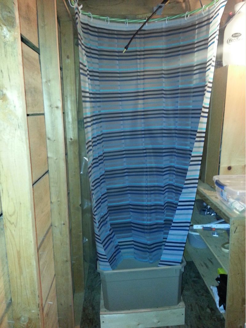

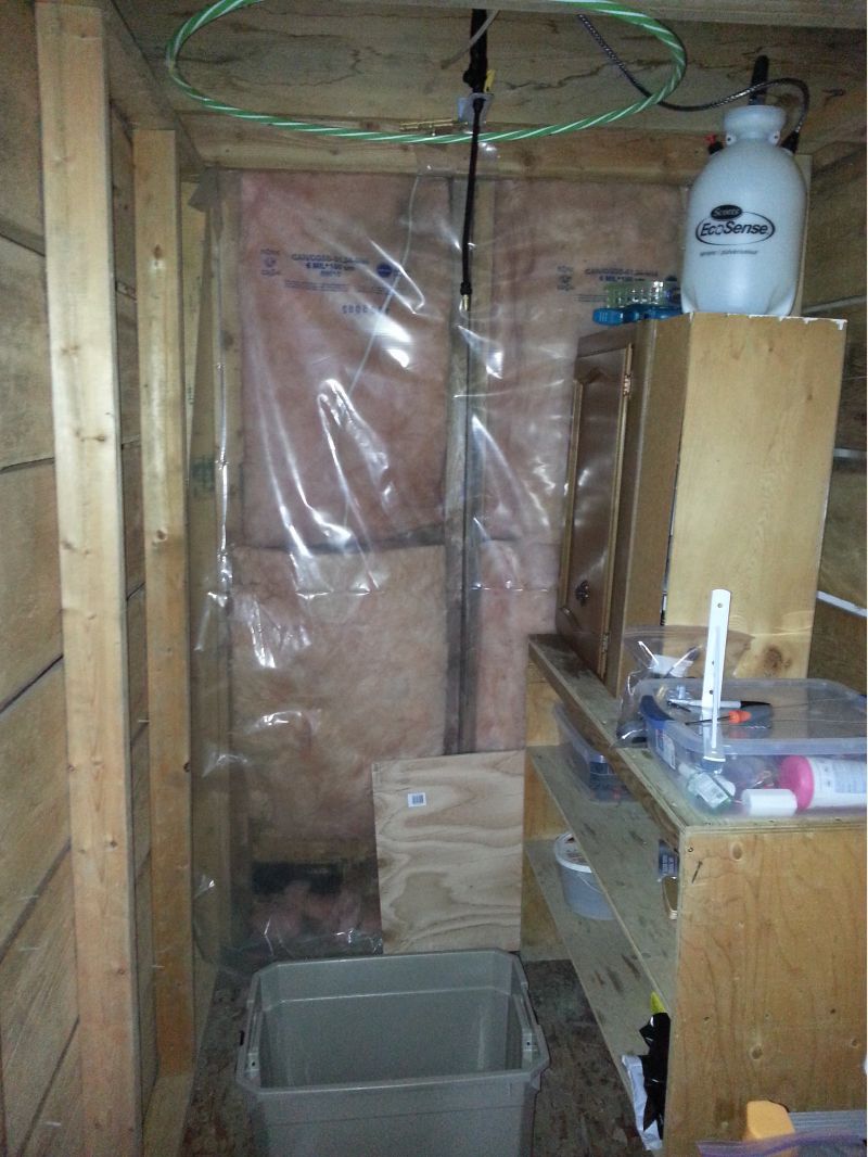

Okay, so here's the deal.

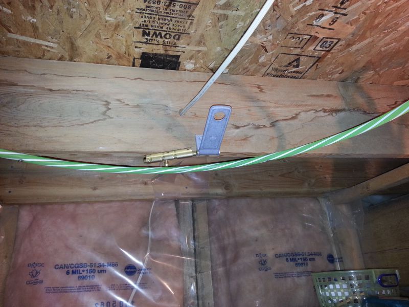

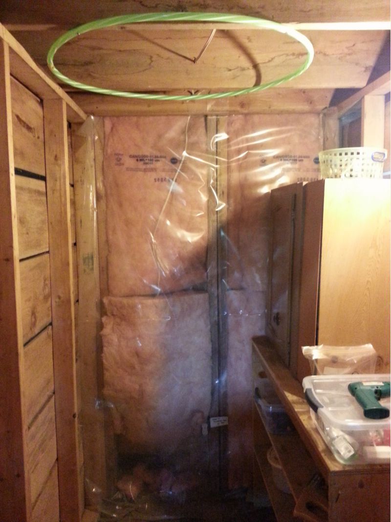

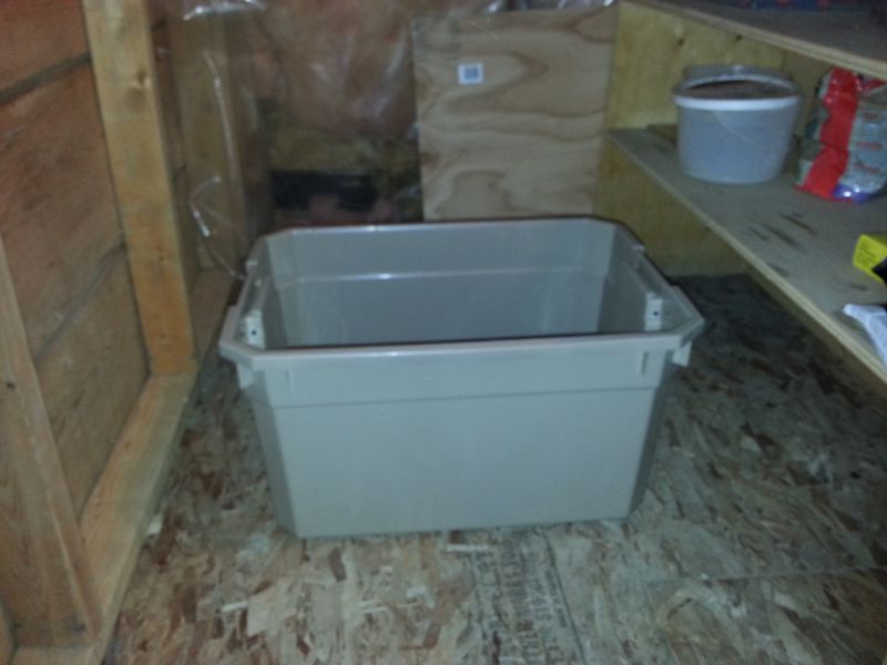

As I think I mentioned, the back ~ 40 % of the cabin is divided into 3 rooms. The two corners are bedrooms. There is a middle "utility area" that was being used for storage. This is going to be the "bathroom" (I use the term very loosely at this point) for the cabin. (Above these three rooms is a small loft where the kids like to sleep - the 3 of them seem to have a rotation where 1 or 2 of them are in the loft and 1 or 2 of them are in the "kids' room" corner room).
This "utility area" is kind of narrow but deepish. Just wide enough for our purposes actually.
I wanted a "circular shower" with no structural support, like the "red and white polka dot shower costume" in The Karate Kid movie.
I liberated a hula hoop (apparently I paid $1.50 for it at the Dollar Store at some point) that I found in the garage. I screwed this into the floor joists above in four places. It actually holds pretty firmly.
You can see the fairly standard plastic storage bin that was chosen for the "tub" of the shower.
Sprayed water is provided by a 3 gallon "pesticide sprayer" thingy that I got for about $40 from Home Depot or Lowes (purchased new, never used for pesticides).
If I fill the sprayer 1/2 full with room temperature water, and 2 or 3 kettles of boiling water are added, the resultant temperature is in the high 30 / low 40 deg C range - perfect shower temperature.
I experimented at home with this first, and determined that after pumping the handle to pressurize the unit, I could get 2-3 minutes of "spray time" before the pressure runs out. There is enough water in the unit to do that about 5 times. In practice, we didn't need much water at all - 2 adults and 3 children showered, and we used less than a gallon of water. This involved the same-gender parent "hosing down" the appropriate child(ren) - kids are only between 5 and 9 years old and not tall enough or coordinated enough to use the contraption themselves. Since we aren't used to having a shower at the cabin, we forgot bodywash / shampoo, and had to settle for pump hand soap "field expedient" bodywash. Which is to say we did not wash our hair - it's possible we may have needed 2 or even the whole 3 gallons if hairwashing had occurred also.
You can see from the photos that the shower curtain was both too short, and insufficient in "circumference." I had actually calculated the hoop's circumference at home ahead of time, but somehow this did not get communicated adequately to my wife (who bought the shower curtain). No big. We'll get another curtain and duct tape the edges together or something.
You'll also see the shower curtain was too short. I made an elevated platform out of scrap wood (my carpentry skills leave much to be desired, but the box did not collapse under my 175 lbs, so it worked out).
Admittedly, the setup is more than a bit "ghetto." Personally, I don't care - it's a cabin. We now can have indoor showers at nearly the same temperature as at home, which is pure luxury. And the whole thing probably cost $75. And we can use the sprayer to wash dishes too.
I'm just going to work on the water heating part a bit more. In the winter, I'll just have a jerry can / non-heat sensitive container kept near the wood stove for this purpose. In the summer, I'll probably just throw a water container into my Jeep and try to passive solar heat it instead.
Well, there you have it. Not sure if anybody would actually use this design as an example they'd want to try, but hopefully, some of you at least find it amusing.
Take care and have a great day!

Question about the dirty water. What's ya doin with it? Like the hula hoop.
sarcopenia
# Posted: 25 Aug 2015 01:39am
The bin is simply lifted up and the "dirty water" is umm, disposed of ... outside ... in an "environmentally responsible" manner.
I thought about digging a "grey water drainage pit" thingy, by burying a 55 gallon drum underground with holes drilled into it, gravel layers inside, etc. Then, I could just connect a pex line from the side of the bin, through the wall (which I'd have to drill through," outside, and into the ground and the pit.

Here's an option for hot water in cold months:
http://hilkoil.com/
I've used this for over 3 years to heat my household water in the winter flawlessly. I build ONE fire to heat my house, heat my water, and cook.

We did something similar but without room in the cabin, put up a small resin shed that serves as both the john and shower.
A pass through was created for a 12v shower similar to a zodi (but better. I have had both) and is closed off when not in use with an outdoor outlet cover.
Hot water is provided by a propane powered turkey fryer (Canadian tire)
The shower frame is built with pvc pipe and we use a wide plastic container as the shower base. That sucker gets heavy after a shower so we drain it with a Canadian Tire cordless drill pump. Just run the hose back out the pass through and drain away. This empties it in an instant and saves struggling in that small area.
Got to love small cabin ingenuity we all have here lol
