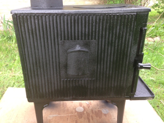

# Posted: 22 May 2014 12:09am
I am going to struggle with that this winter I believe. I am hoping that the wood stove will only be slightly too big for our Michigan winter. I am happy though that I have a very small wood stove. I may be switching over to the Dickinson in the spring...lol. I will have to let ya know. Woodstove.JPG

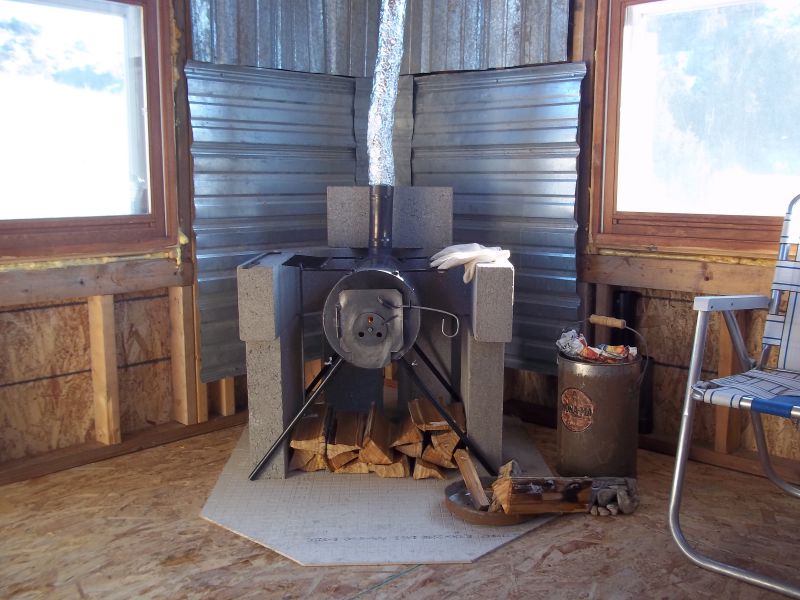

# Posted: 29 May 2014 06:25pm - Edited by: neb
I have this one I installed last winter and really does a great job for a 10x12. One of the posters has a link for this stove in their post. The only thing you need to do is keep it loaded with wood. This will heat up a small area really nice. I might even take down the tin because it didn't even get warm and do something else on the walls. Good luck. I paid 56 buck shipped to the door.

smallworks
# Posted: 14 Jul 2014 11:21pm
Quoting: brooksm29 I am happy though that I have a very small wood stove. That's our stove, too- a Reginald 101- and we heat our house with it (not the camp), 860 sq'. I think the company became Waterford. It's beautiful and keeps us warm. Yours is in really good shape. We've been using ours for 21 years.

brooksm29
# Posted: 15 Jul 2014 01:59am
smallworks- It is definately in good shape but I think it is too large for my 100sqft. I do not know (at this point) what I will be heating with this winter...lol. Leaning towards a small coal stove I believe. I have been told you can burn either wood or coal. They are typically much smaller. It still poses the getting up in the middle of the night problem but it will be much more tolerable during the day.

# Posted: 19 Jul 2014 09:04pm
NEB - how'd you go from the stove to the chimney? The sections that come with it ain't gonna do it for me either
# Posted: 19 Jul 2014 10:24pm
R9R Not sure if I understand your question sorry. From the stove to the chimney I went to a muffler shop and they flared the over end of the pipe so could mate the pipe the right way. They did it for me at no charge. Then I went and got a piece of high grade flex pipe that is used for piping engine exhaust and formed to go up through the roof. The first piece of pipe from the stove is a shorter piece of then went up from there. The top three pieces of pipe are pipe that came with the stove. I hope this helps. I have some better pictures I will post one. Good luck my friend.

# Posted: 28 Jan 2015 12:41pm
Hi there! We're to that point in our cabin -- if you get a chance would love to see a little more of your setup Not tryin' to re-invent the wheel here
# Posted: 28 Jan 2015 08:33pm - Edited by: neb
R9R>>>>My setup works just fine for what I need it for. Of course I don't live there but really does a great job. A few things I'm going to do is get a 1/2 inch piece of steel plate and will lay that from one side of the brick to the other. This will keep heat down and it will also heat up that steal plate for longer lasting heat. The other thing I will do is cut a 2 inch hole in the floor close to the stove for outside air. My shack is very tight and I need outside air intake. I will do that this spring. I was there last weekend and got the inside to temp to 70 degrees very quickly and I could maintain that temp while I was there.

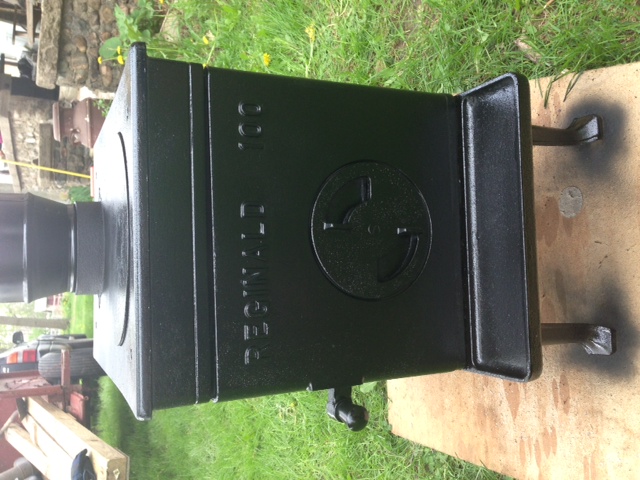

wonderland
# Posted: 23 Jan 2016 09:49am
brooksm29
Hi,
I've seen you have a reginalad 100, like us. We got it as a present and want to get it working again. We are looking for spare parts. Do you have any idea where we can find some? Thanks!
