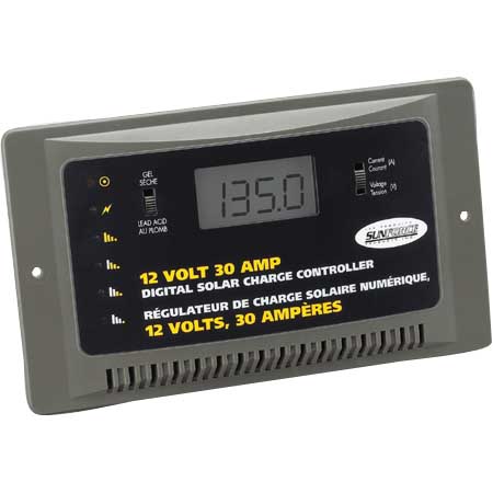

Curtis,
Thanks for sharing your experience with solar power setup.
I looked up that 30A charge .. quite nice thing indeed. It also said it works with both lead acid and gel cell batteries (some people prefer those).
30A Solar Power Charge Controller
Enjoy your cabin living!
