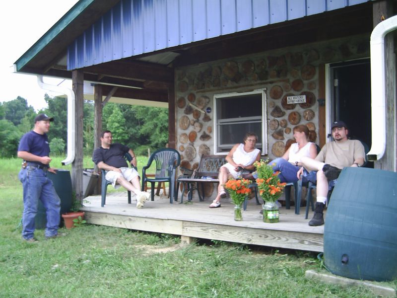

We're searching for non-electric solutions to cool our off-grid cabin in the summer.
Our cordwood walls keep the inside about 10 degrees cooler than the outside air. But the humidity in Kentucky is what really makes you miserable.
We tried Earth Tubes, but they don't work in high humidity. They just blow moist, moldy air. Earth Tubes are only an arid climate solution.
Solar/battery room fans just kinda blow the stickiness around.
Planted a bunch of trees, but they're still too young to provide any shade.
Sure would love to hear some other suggestions - it's getting hot out here!!
Porch Sittin' Time
Porch Sittin' Time
