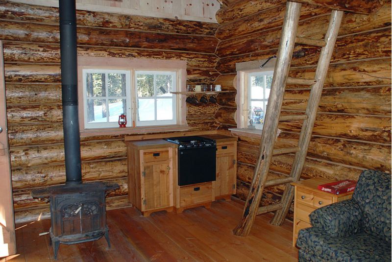

My cabin is 180SF. The first stove I tried was surprisingly, too small. It was about 60 years old, un-used condition. It was $500 on craigslist, a couple hundred over what I intended to spend but much less than 'new'.
Then I got a bigger stove (for free on craigslist!) that is rated for 1100SF and it's OK for my 180SF. It doesn't burn me out as everyone said it would, but it could be the wood I'm using. I really like the stove, it has glass windows, front doors, a top-loading door, thermostatically controlled, and little warming shelves.

Vermont Castings "Intrepid" stove, 1982.  It's OK for 0degF

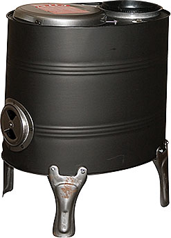

offgriddream
# Posted: 13 Jan 2012 01:30

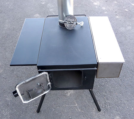

check out this site they offer tent stoves. for wall tents I dont know if this will work or not
http://www.walltentshop.com/FourDogStoves.html
four dog stove
four dog stove

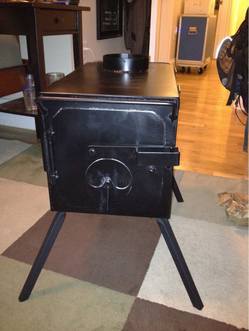

# Posted: 13 Jan 2012 08:39 - Edited by: sabiggs

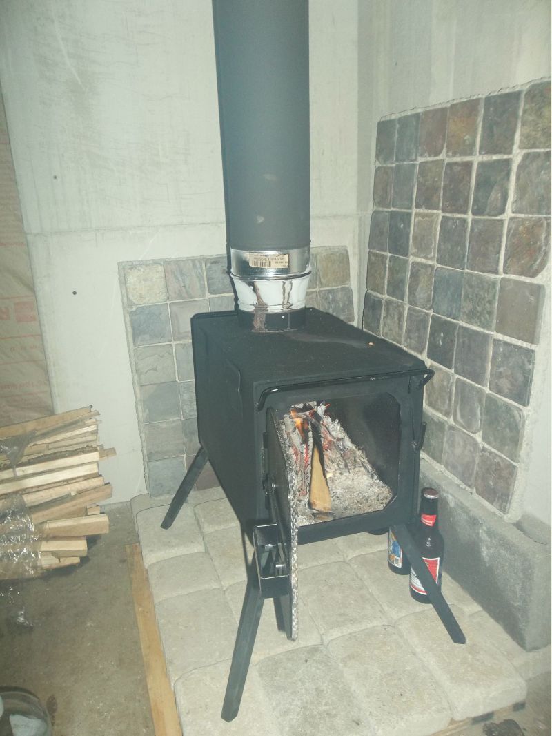

That stove above is actually the exact stove I'm installing in my cabin this very weekend (see Vermont Cabin Project). I got the Two Dog stove, not the four dog stove. Was reasonably priced and seems to be very well USA made. My place is 10X12.
I'll be sure to post pictures after this weekend to give results.

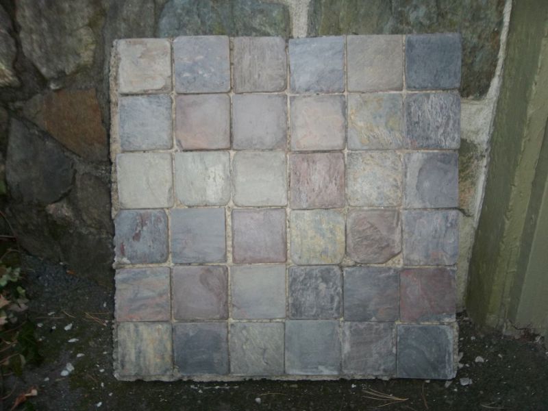

# Posted: 13 Jan 2012 09:21 - Edited by: sabiggs
bhebby, will do.
The pipe is 5" but we got the connector piece from the same guy to make it 6". We're going to space it between 10-12" from the wall with cement board and then a homemade 1.5 inch thick cement/ tile "backsplash" and ceramic spacers. I'll be sure to have lots of info on Sunday night. When you call the #, I think you actually call the guy's home phone (the guy who actually makes the stove). Kinda nice.
Look for my post here or in my own thread "Vermont Cabin Project" with updates on how it went.

# Posted: 13 Jan 2012 10:20
The "'Dog" stoves are very nicely welded sheet metal stoves. The metal sides. top, back, etc can get very hot. They can glow red with a big fire. There's no firebrick in them. As such you need yo be careful whrn using one. If that cement board is mounted flush against the studs with the tile on the cement board heat will be directly passed by conduction to the studs.
There 's mention of the dangers of that and how to make a heat shield using an air space behind it and the combustible materials in this thread...
heat shield
sabiggs
# Posted: 13 Jan 2012 12:17
MtnDon,
I appreciate your comments.
As I said in my post, we're using the 2 dog model and will have a 1 inch gap space with ceramic spacers between wall and the cement board. Then, in front of the 1/2 inch cement board, I made myself a separate cement "wall" that is 1.5 inches thick. Mounted on the top of this cement "wall" are the slate tiles. That's basically 2" of cement and cement board and then an additional 1" of air space before the stud wall.
You probably know more about this than me, so I'll ask you specifically if you think we're still looking at trouble spacing the stove about 12" from the wall given the precautions we're taking, as listed above?
Thanks for your time and thoughts.

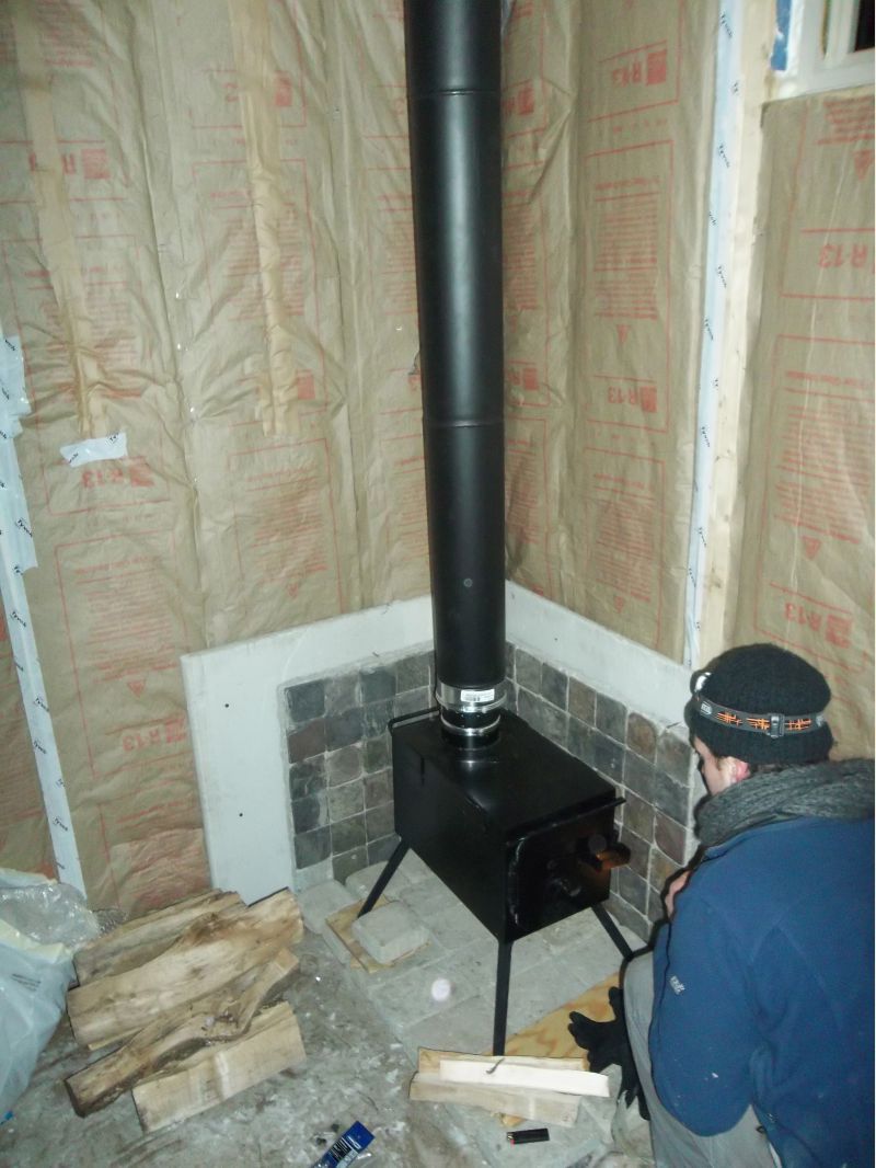

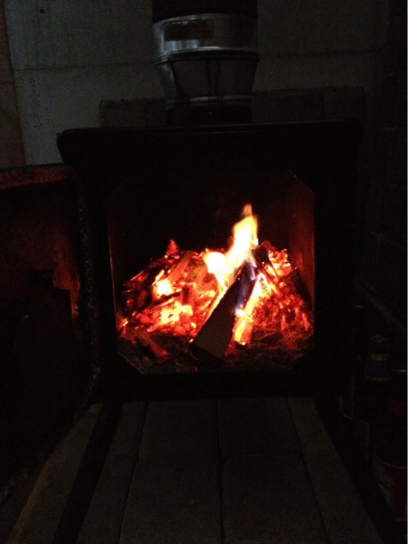

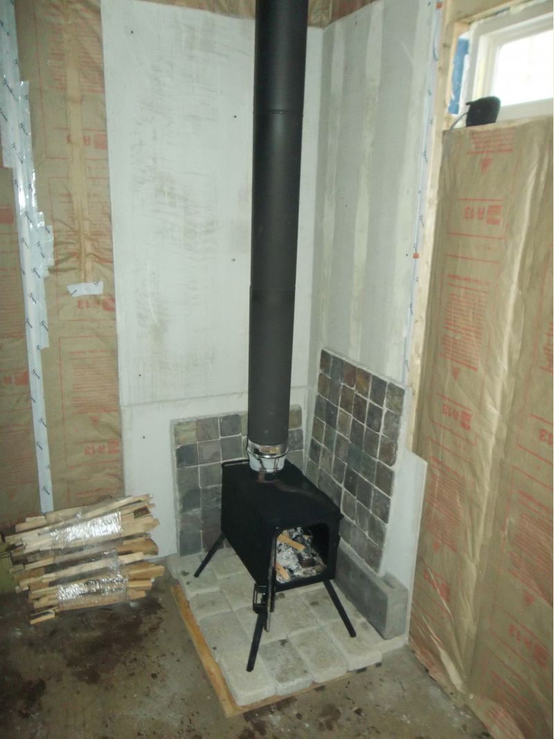

# Posted: 15 Jan 2012 20:26 - Edited by: sabiggs
bhebby,
Just got back from installing the "2 Dog" wood stove. It went great, after some modifications.
It was zero degrees outside today, but the stove easily heated the place to mid-60's, without us feeding it any seriously large logs.
The stove burns very hot, especially on the sides. Our clearance ended up 18" in back and 12" on the side. there's a 1 inch gap between the wall and 1/2 inch cement board (all the way up the wall), and then a 1.5 inch cement tile board. The backside wall never got too hot even to the touch. The side wall at 12" got VERY hot the first night, so we extended the cement board all the way up the wall, bought 2 half-sized concrete blocks and moved the 1.5 inch cement/ tile board up the wall. Did the trick.
We also learned the stove doesn't need much to get hot. We overdid it the first night and ended up with some smoke in the cabin. We learned to use fewer and smaller pieces of wood.
Let me know if you have any specific questions about the 2 dog. I HIGHLY recommend it. Our cabin is 10X12 and it works perfectly for us.
