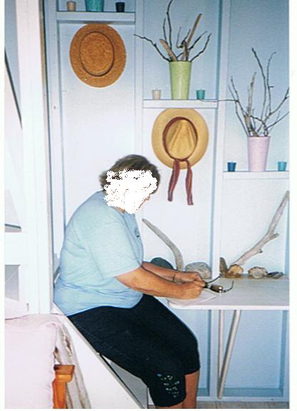

I had a cabin i built with no insulation . like you we had no plans to use it in cold weather . it was a singal skin 8x13 . plywood siding over 2x4 studs. we painted it inside and out . we heeted it with a 1500 watt electric box heeter . i only slept in it once below40*but it was nice and warm in the sleeping loft.if i were to add inside wall finishes i would for sure go with the insulation!! you never know if your plans could change to include cold weather use !!

dear just. i love a cabin if it has no insulation.i love what u did with your cabin walls.this is so nice.ledges to store stuff or decorate.we sleep in our.well our main cabin walls are insulated but not our kitchen.i know one year we were out on 5 acres n in a small camp trailer.we would wake up to ice on the inside windows.we were warm but we had lots of fresh air.so we eventually had to move to town for the winter and i tell u...from the very first we were sick and stayed sick.when we were in our woods,we were never sick once.
so i think all the really air tight homes are not always good.
but it is important to save energy.i was just commenting on what i saw about our health.
we have slept in our cabin and stayed warm but we have a little buddy stove.its small and propane but sure puts out the heat.thank u for sharing your cute place
