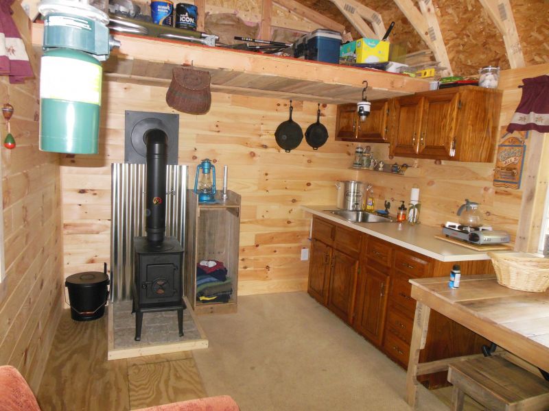

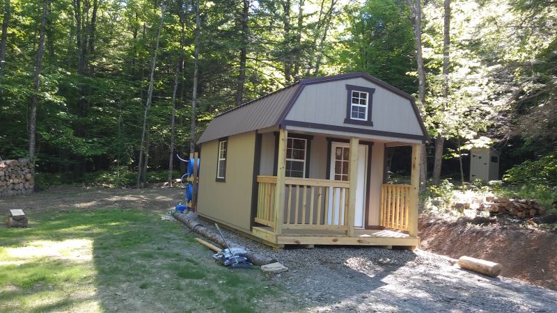

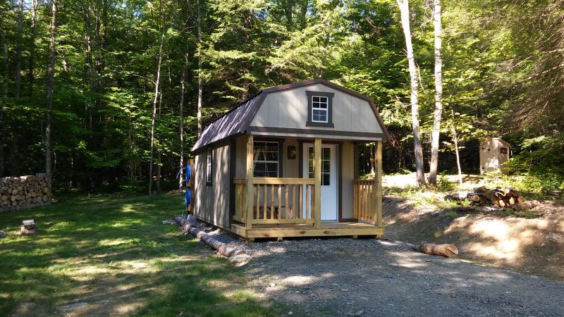

I did buy a cabin from them and I have to say it is very well built. They are using 24" oc (double studs on plywood joints) system and everything is done with 2x4 but you can always upgrade to 2x6 or bigger or 16" oc. They have free delivery up to 30 miles.

Nice! Thanks for posting the pics. (I see your water tanks in the back too.)

I've had it for over a year now and no problems with it. I upgraded my floor joists to 2x6s. Last year during hunting season I used Mr Heater big buddy to heat it up and it kept it toasty all night long. Of course I cracked the window open. The interior is 10 x 16 all insulated now. If you plan on insulating the ceiling leave 1" gap and cut ridge vent, the cap is screwed in and then drill some holes in overhang, this way you will not have moisture problems. I also bought it in Davenport NY. For the money you really can't beat it.
